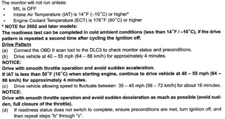

Can my truck pass the smog if just today I reset the computer to turn off the check engine light
Jul 29, 2010 at 6:29 PM
DAVE H
  • 13,384 POSTS
In most cases a drive cycle will need to be completed .. drive cycles are different for the different DTC's .. this example is for a repaired catalyst DTC ..
https://images.2carpros.com/forum/automotive_pictures/266999_tun_2.jpg
