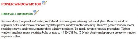

how do you replace passenger side window motor?

https://images.2carpros.com/forum/automotive_pictures/261618_Noname_834.jpg
