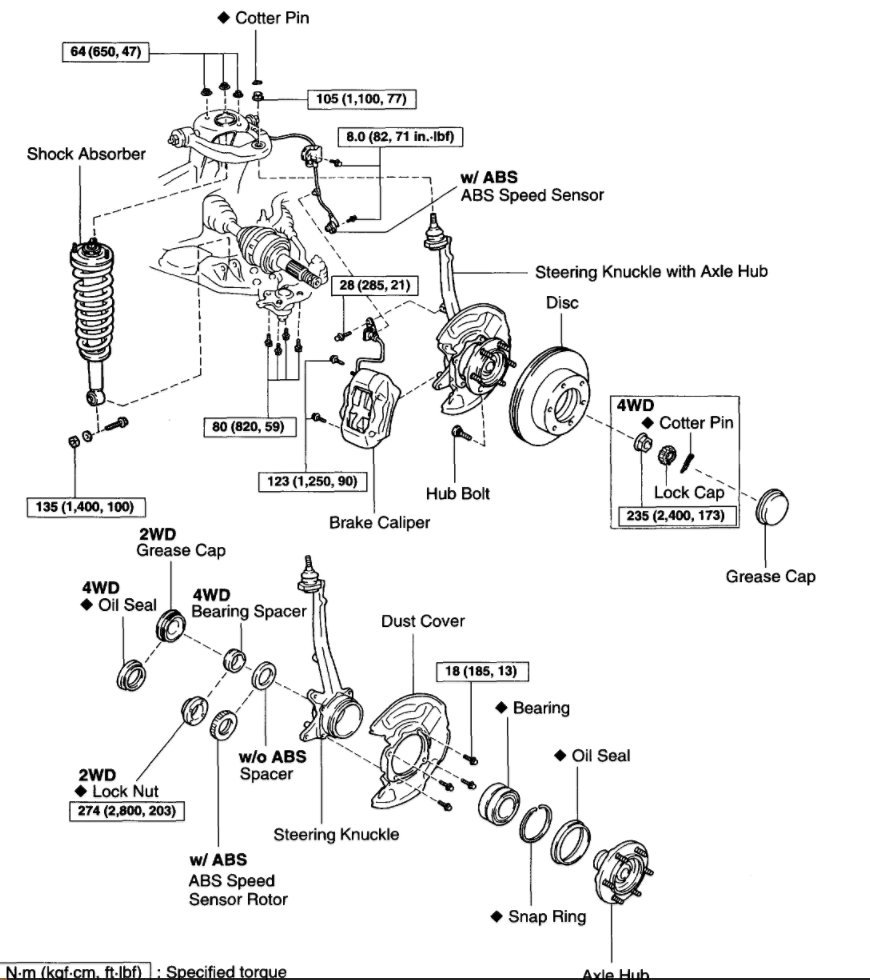

I need instructions on replacing the wheel bearings on my 2000 tundra.

Here is some a guide (below) for your truck as well.

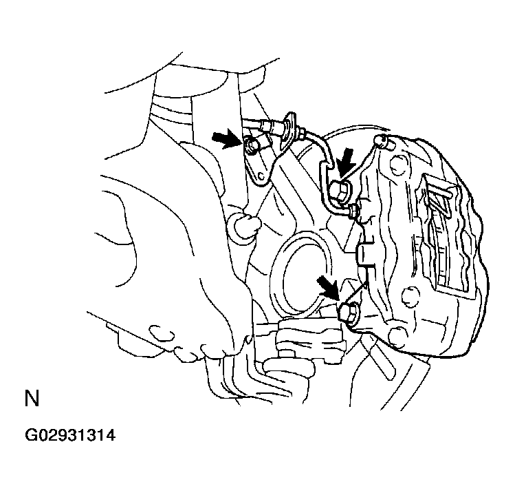

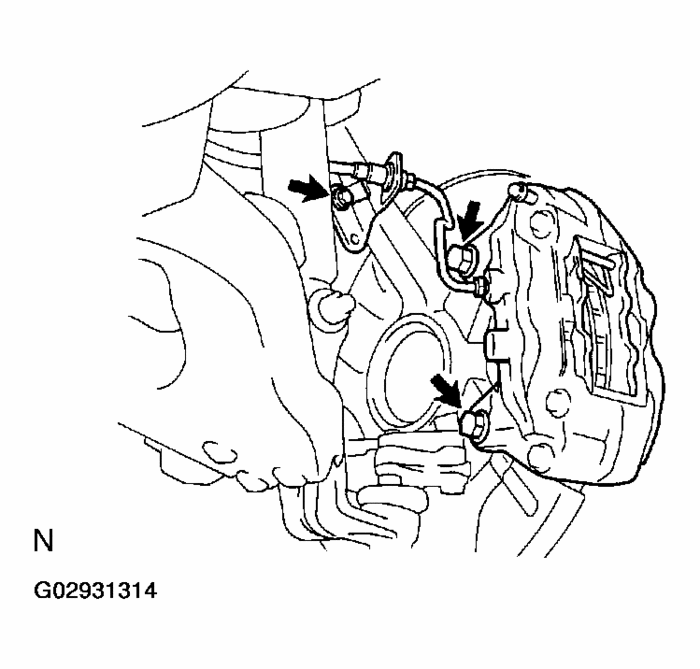

REMOVE BRAKE CALIPER AND DISC
Remove the bolt and brake line clamp from the steering knuckle.
Remove the 2 bolts, brake caliper and disc.
Support the brake caliper securely.
Fig. 1: Removing Brake Caliper And Disc
Courtesy of TOYOTA MOTOR SALES, U.S.A., INC.

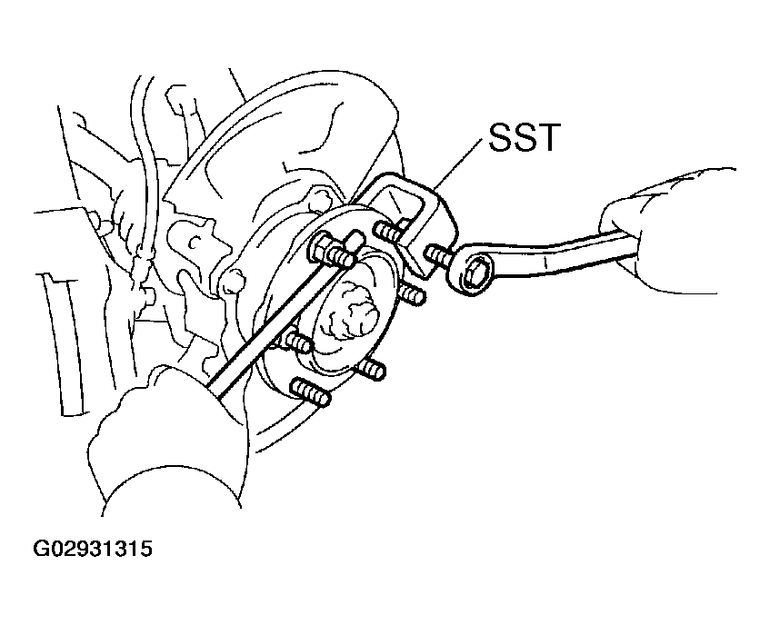

REMOVE HUB BOLT
Using SST and a screwdriver or an equivalent, remove the hub bolt.
SST 09650-1701 1
