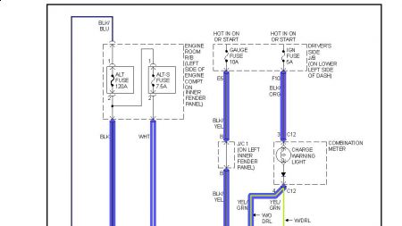

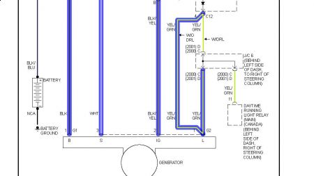

My 2000 Toyota Tundra is not charging when the engine is at idle speed. I replaced the alternator with a brand new one. The battery was tested and the belt replaced. What else could it be ?
Feb 10, 2010 at 8:28 PM
  • CAR REPAIR CONTRIBUTOR
  • 75,992 POSTS
Check all the fuses and double check connections -see below:
https://images.2carpros.com/forum/automotive_pictures/12900_a1_6.jpg
https://images.2carpros.com/forum/automotive_pictures/12900_a2_6.jpg
