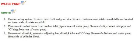

I want to change the water pump do I have to touch the timing belt to change the pump?

Instructions for removing water pump.
