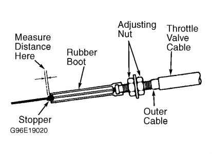

I just finished replacing the oil pan gasket, transmission gasket & filter, and the rear oil seal. put it all back together with out chilton manual (which i cant seem to find). So now my problems is no leaks but shifts late (i think) at about (20 and 55). Can you please give me instructions and steps to adjust it?

First you will need to adjust the TV (throttle valve) cable from the trans to the throttle.This should take care of you problem
https://images.2carpros.com/forum/automotive_pictures/1639_tercel_2.jpg
https://images.2carpros.com/forum/automotive_pictures/1639_tercel2_1.jpg

okay ! i adjusted it per instructions provided. itnow shifts at approx. 20, 40, & 45. if i step on the accelerator it shifts at 30, 50 & 55. sound right?

There is no spec for speed of shifts, so if it feels right to you, like it did before then it should be fine.Those speeds sound about right
