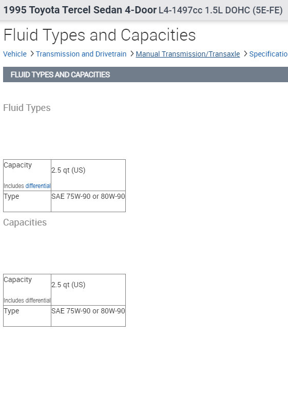

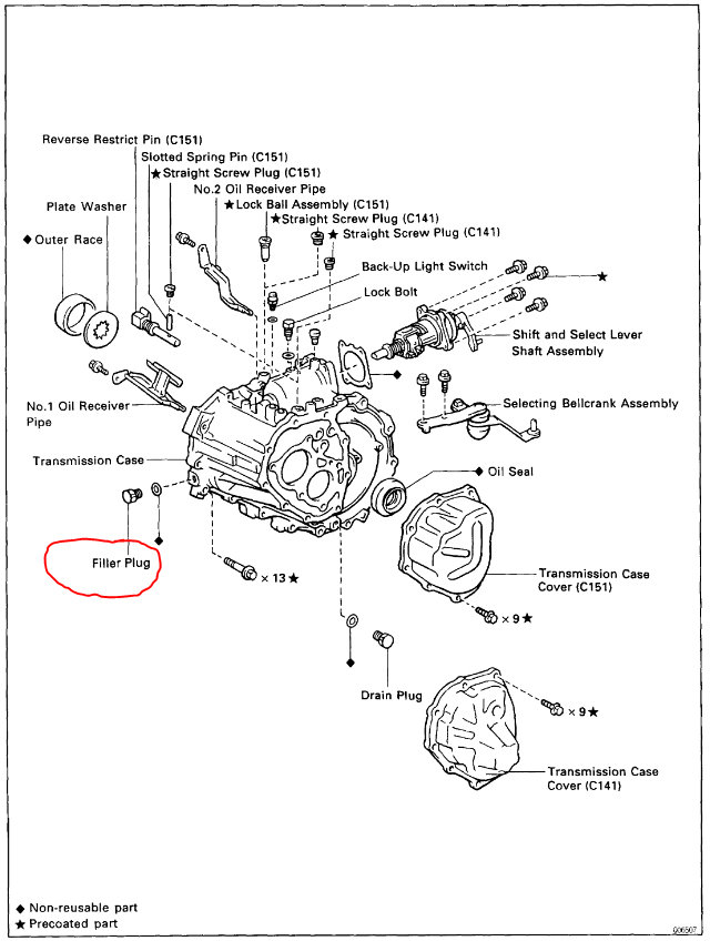

where do I add gear oil? my car pops out of 3 and 4the gear I was told I need gear oil but I cant find where it goes.

The manual transmission fill plug is located on the side of the transmission case.
I have attached a diagram showing the location. The fluid level should be right at the level of the plug.
This vehicle uses 80W-90 gear oil for the manual transmission.
