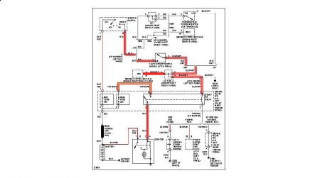

i push the clutch down turn the key and everything comes on but the car doesnt turn over. what is going on?
May 29, 2009 at 9:40 AM
  • 75,992 POSTS
If the starter can crank the engine while being remote started -Check the starter relay and clutch start switch.
https://images.2carpros.com/forum/automotive_pictures/12900_starter_28.jpg
