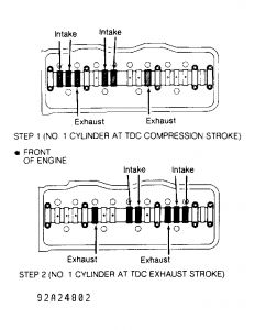

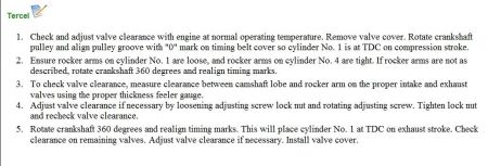

Engine Mechanical problem
1992 Toyota Tercel 4 cyl Two Wheel Drive Automatic
How do you adjust the intake & exhaust valves adjustment sequence
