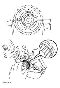

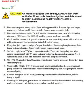

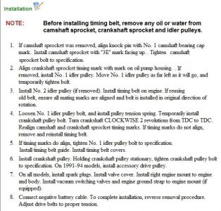

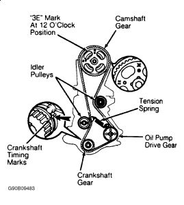

would like to know the particular things to change and tips to aid the project, Thanks!
Mar 25, 2010 at 2:42 AM
BLUELIGHTNIN6
  • 16,542 POSTS
when changing timing belt, some people also prefer to replace the water pump at this time since removing the timing belt is the biggest part in replacing the water pump..
