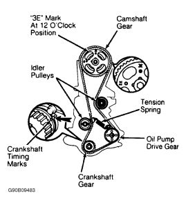

1991 Toyota Tercel Timing Belt
GEMINIL2000
  • 1991 TOYOTA TERCEL
  • 4 CYL
  • FWD
  • 240,000 MILES
How does one change the timing belt?
Thursday, July 10th, 2008 AT 11:33 PM
MHPAUTOS
  • 31,937 POSTS
Hi there,
You have to remove the front crankshaft pulley, timing covers drive belts to access the timing belt. Timing marks are as per pic, If you have never done this type of job before i would suggest you purchase a work shop manual as it will give step by step instructions with picture as well.
Mark (mhpautos)
