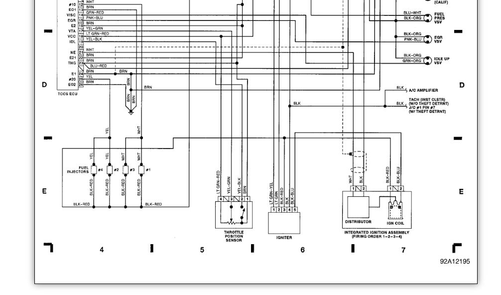

Car turns over but will not start. I would like to know location of the crankshaft sensor.
Monday, August 9th, 2010 AT 12:00 PM
4 Replies
BLUELIGHTNIN6
  • 16,542 POSTS

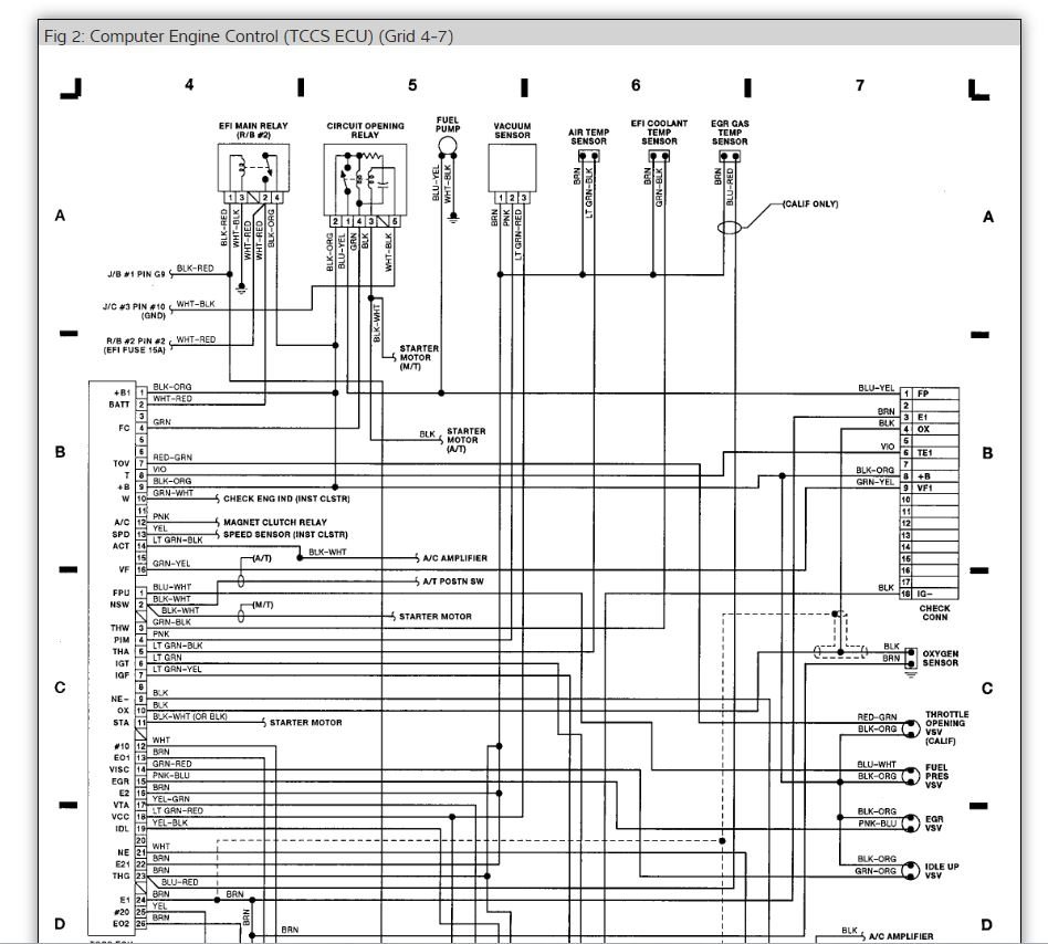

In 1991 Tercel's did not have actual crankshaft position sensors. Engine speed is sensed via pick-up coils in the distributor. This information is sent to the ECU and used to determine crankshaft position and engine rpm. Crankshaft position is input through terminal G and engine rpm is input through terminal NE of the ECU.
Check the guide below on how to test wiring as well as the guide on how to use a volt meter. Also attached is the wiring diagram for the ignition system to help you figure it out.
Let us know what you find.
