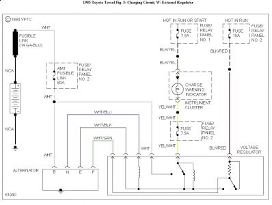

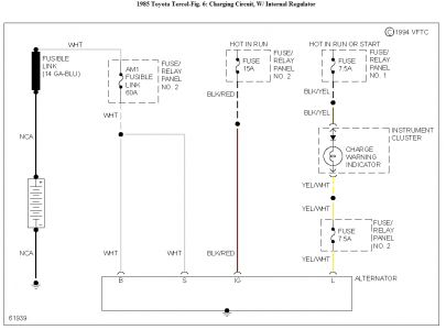

1985 Toyota Tercel connecting wires to alternator
1985 TOYOTA TERCEL
BSOTO48
Electrical problem
1985 Toyota Tercel 4 cyl Two Wheel Drive Automatic
what wires goes on the alternator
Apr 1, 2010 at 2:49 PM
MERLIN2021
  • 17,250 POSTS
There are two systems on these one has an external voltage regulator, the other has the regulator internal to the alternator, here's both...
https://images.2carpros.com/forum/automotive_pictures/62217_Charge1_1.jpg
https://images.2carpros.com/forum/automotive_pictures/62217_charge2_1.jpg
