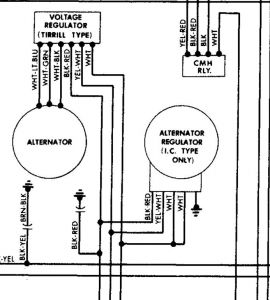

i have an 83 toyota tercel station wagon 4x4 i think it has a trouble shooting in the charging system and it does not charge and also blows the fuses out. I think it can be the charging relay but i don't know where it is located.Can you tell me were it is located please?
Due to the problem mentioned above i took out the external alternator regulator and i installed a new internal
regulator,but i dont know how to switch the cables or wires.Could you please help out on that?

Hi jesaram, Here is a diagram of the alternator circuits for both circuits.
https://images.2carpros.com/forum/automotive_pictures/192750_Alternatorwiring83Tercel_1.jpg
