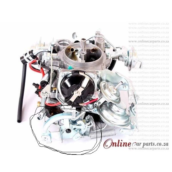

Thank you kindly for the swift reply, I have diagnosed the following error on my carburetor
just for the record it is a carburetor motor, I have checked your advise when i started my car this morning, I have noticed the following,
On the Image i have circled the part that feels loose and when i move that certain part i can hear the difference in the idling
Can that present a problem? also when i rev the car i can hear kind of a whistling noise coming from the carburetor.
But whats bugging me is when i close the carburetor with my hand almost like choking it, it shuts off so i am still not sure how can that make the car to struggle that much.

Is there a cable running to the part that is loose? I believe it is the throttle plate actuator. See if it turns when you depress the gas pedal. As far as a whistle, if the throttle plate shaft is worn (loose), it may be causing an air leak (vacuum leak). That will cause idle issues. Now, if that is the throttle plate, that is why you are hearing a change in idle.
Is it possible for you to record exactly what is happening? It may help a lot.
Was the choke closed when you checked it this morning?
