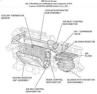

We think it may be something with the fuse but out tacomas AC will only run high and not medium and low

Hi aman117,
Seems the blower resistor is faulty and requires replacement.

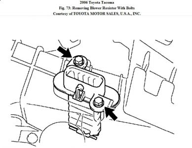

Just had the same thing happen to my truck (exact same model and mileage) today. Is replacing a blower resistor a hard/expensive thing to do? should i take it in or try to do it myself? thanks in advance!

Hi elswarro, Replacing the resistor is not too difficult. I do not have the complete removal procedures but here are some diagrams that should be helpful.

Removing the 2 bolts and you can lift the resistor out. The cabin filter has to be removed for easier access to the resistor.
