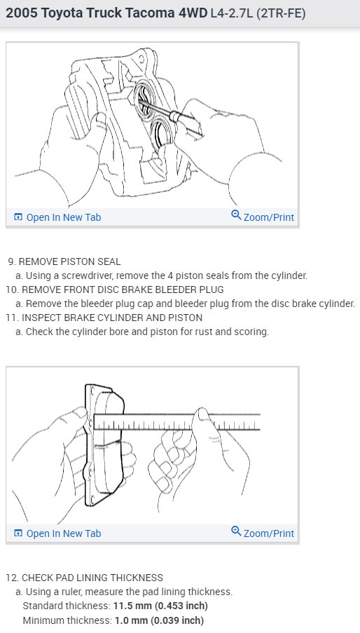

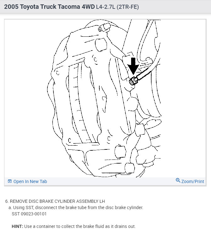

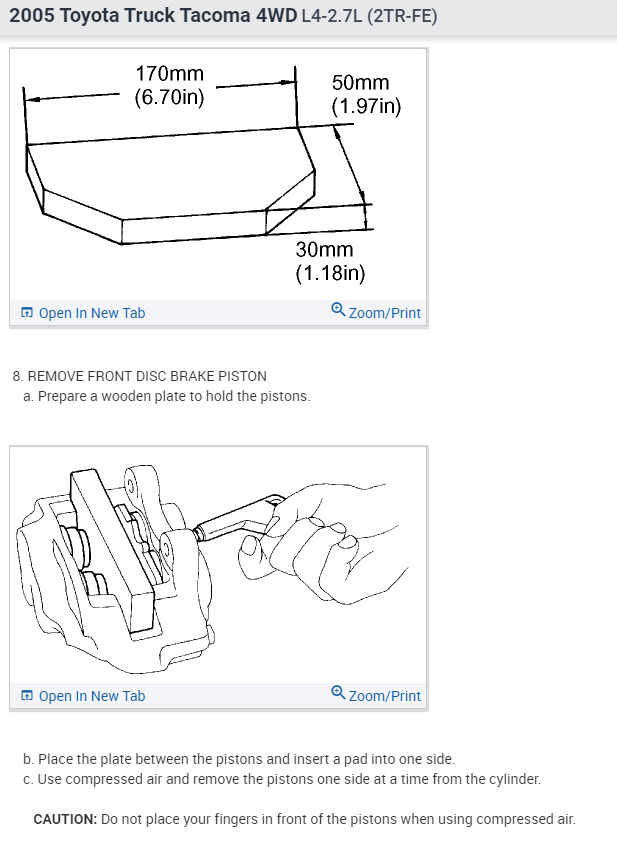

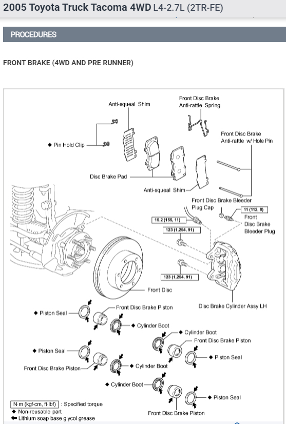

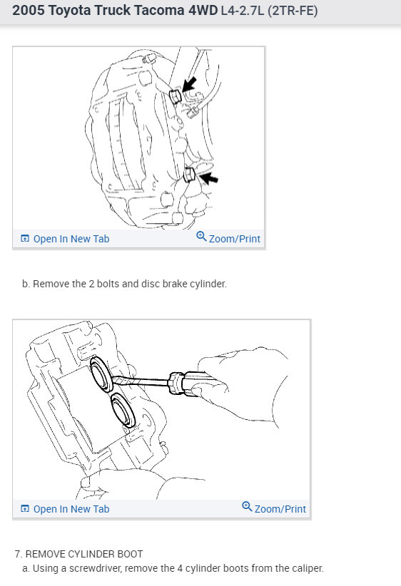

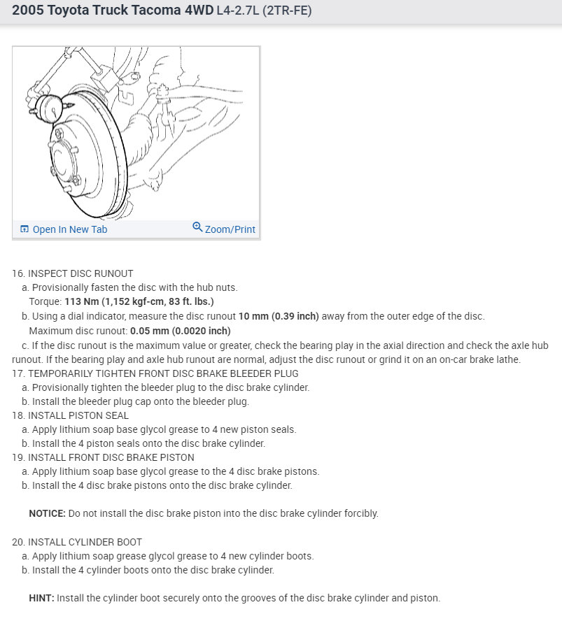

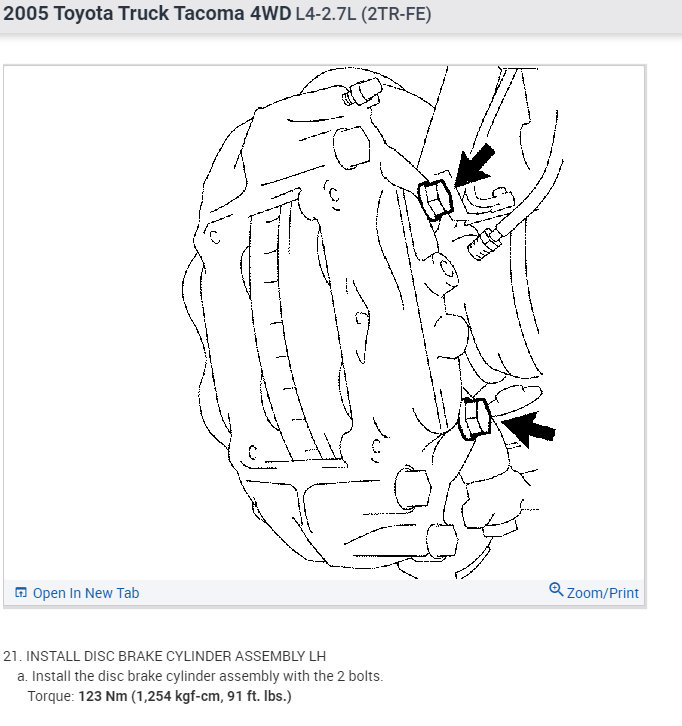

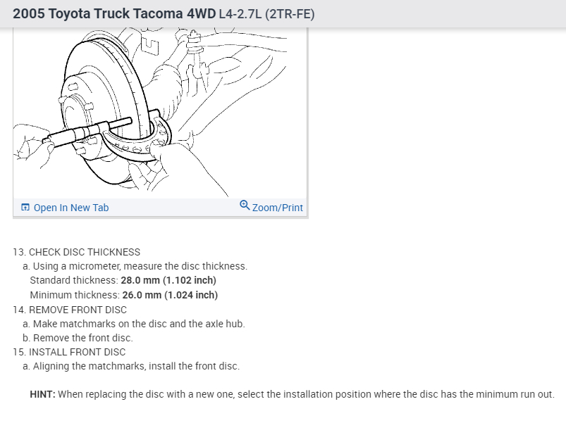

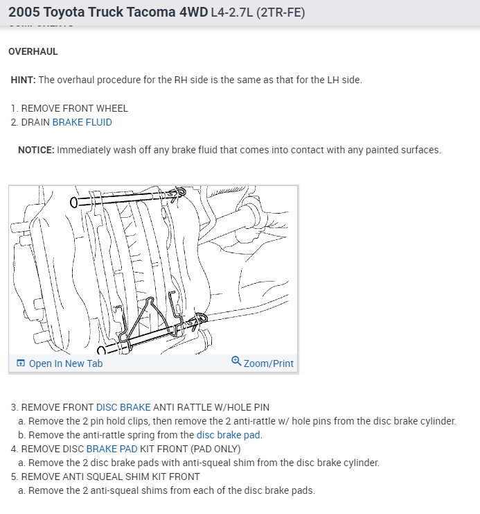

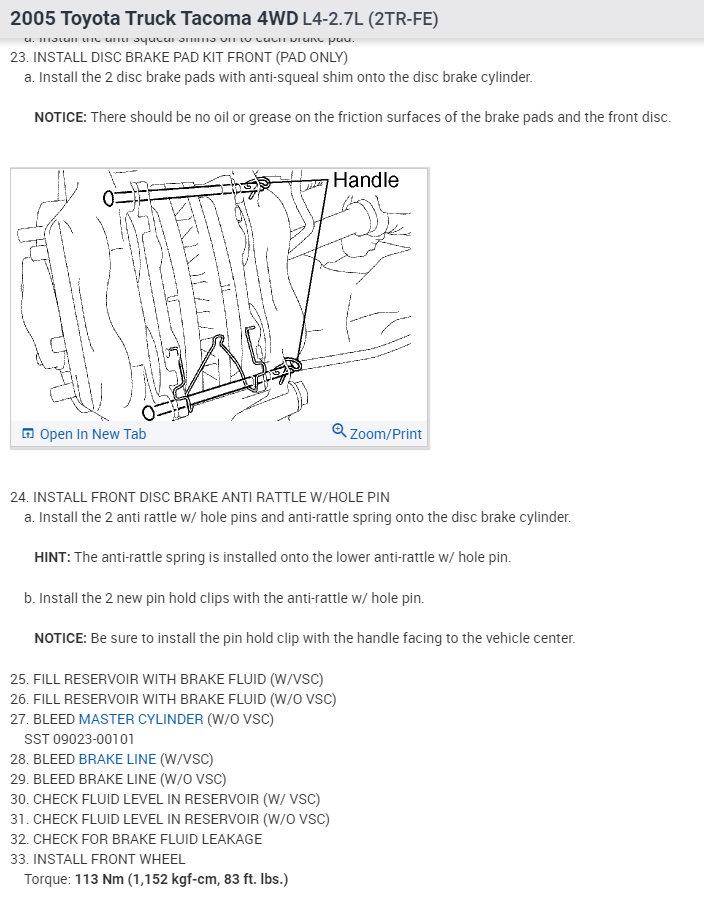

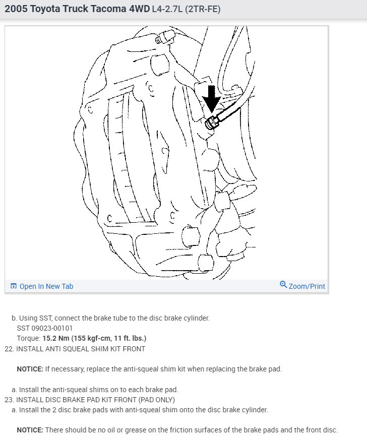

How do I remove the front brake rotor? thank you in advance.
Aug 3, 2009 at 7:58 AM
SQM
  • 6,383 POSTS
The front pads and rotors can be changed using simple hand tools, within a reasonable amount of time depending on your comfort level.
Here is a video that shows all the necessary steps to get them replaced:
https://youtu.be/Gzgh_LVAIDE
