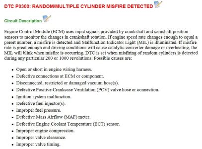

I finally got the trouble codes from Autozone. I believe these are what your looking for if they arent I have the printout. Code #1 p1135 Code #2 p0301 Code #3 p0300 I know one of these codes is for the front O2 sensor. The guy at Autozone told me the other code means I need a tune up but I just had a tuneup about 6 months ago. Also while doing some research on the net I found this one website that said O2 sensors dont go bad they just need to be cleaned. If this is true how do you go about cleaning it as Autozone is charging well over $300 just for the one sensor. Thank you so much in advance

P1135 is a fault with the front Heated O2 sensor or circuit.
https://images.2carpros.com/forum/automotive_pictures/192750_DTCP0300_02Tacoma_1.jpg

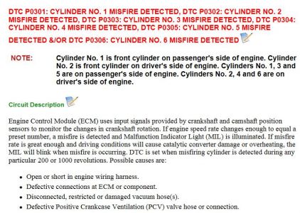

https://images.2carpros.com/forum/automotive_pictures/192750_DTCP0301_02Tacoma_1.jpg
Since only P0301 is present for cylinders misfiring, I would suggest checking the first cylinder spark plugs and ignition coils.
