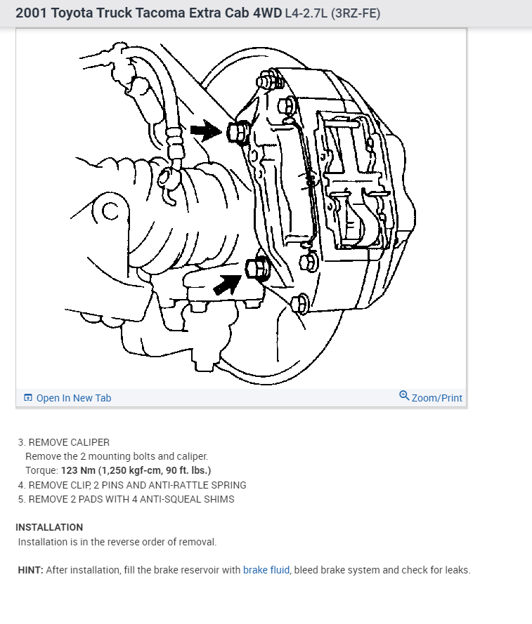

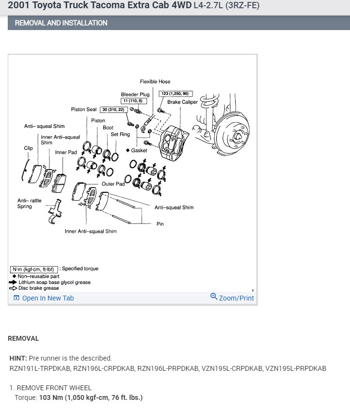

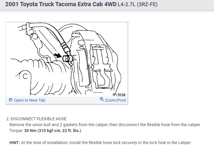

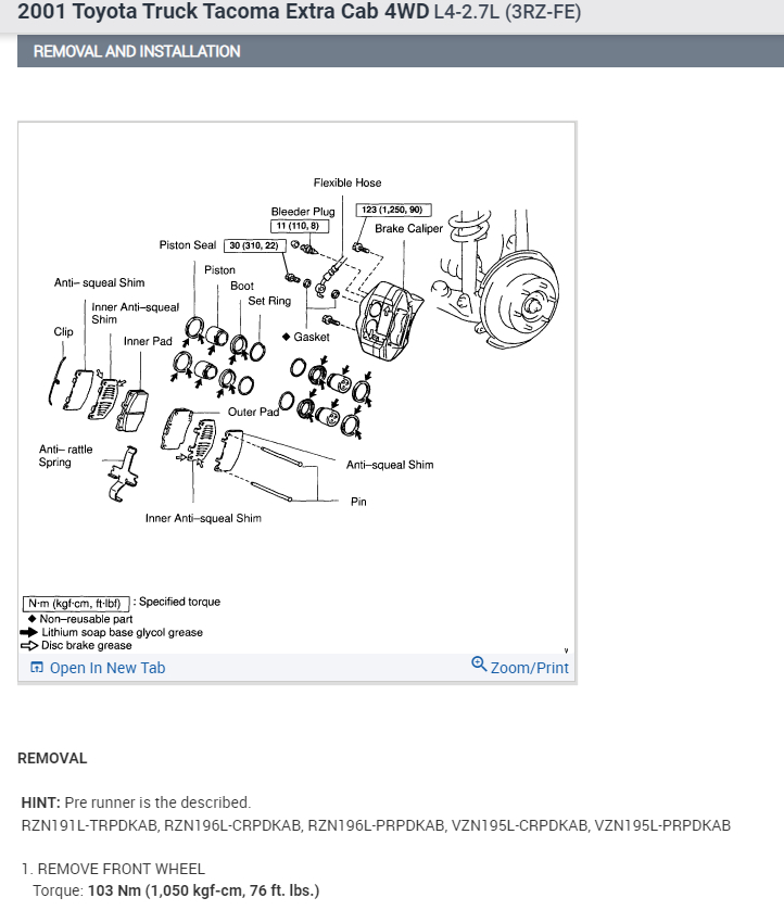

Brake pull can happen due to seized brake caliper slides, failure of a brake hose. It can also happen due to worn ball joint, even due to tire core separation.
Best course of action would be to take a look at each possible area.
Here is a helpful guide that covers this:
https://www.2carpros.com/articles/car-pulls-right-or-left-when-driving-or-braking
Seized caliper slides is one of the common causes of brake pull. Usually this will lead to the seized side having higher temperature on the brake components. After a drive if you use a laser thermometer you can check to see the temperature of the calipers. If one side is significantly hotter than the other side, that hot side is the issue.
