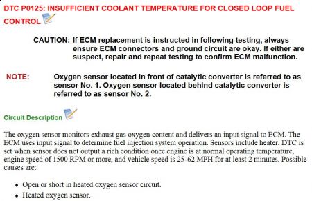

It shows- closed loop fuel control, insufficient coolant temperature.
I think it's PO-0125

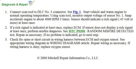

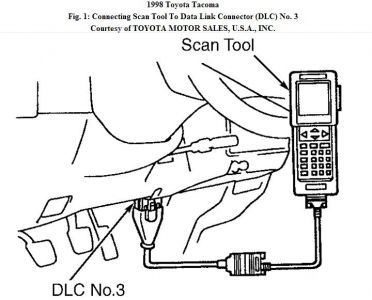

I believe you have got the wrong sensor. The code is for the Heated O2 sensor. Here are the diagnostic procedures.

Thank you for the replies. I have tried to measure the voltage of the oxygen sensor like you suggested but I am not familiar with this function on the scanner.
I'm using the Actron Autoscanner plus model CP9180. I found an option under vehicle diagnostics that shows the RPM of the vehicle along with temperature etc. There is one line that says O2S1 v- I am guessing that's the one that monitors the voltage of the O2 sensor #1...? I snapped the throttle up to 4K RPM's 3 times and the O2 sensor #2 went up to the 0.800-0.900 range while the O2S1 hardly changed at all.

I dont kn oe where KWLow2008 is but he is the local forien guy, But thr upstream 02 is supposed to switch frequently whereas the down dtrem 02 should remain fairly constant, so these are normal.

If the reading of the # 1 sensor is hardly moving, then it should be faulty as it is the upstream sensor, the one before the catalytic converter. You reading are opposite of what Merlin pointed out, as if the sensor circuits had been reversely installed.
Reconfirm the readings.
Jul 1, 2009 at 12:03 AM
CHADLEY22
The sensor before the catyltic converter reads about 0.005- almost no fluctuation, goes up to 0.015 at high RPM...while the one after the cat reads anywhere from 0.025 to 0.975

Yes, that seems to indicate the front sensor is bad.
