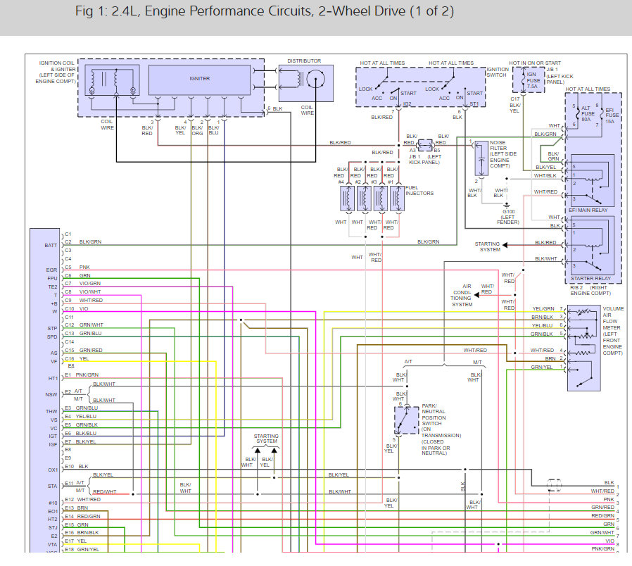

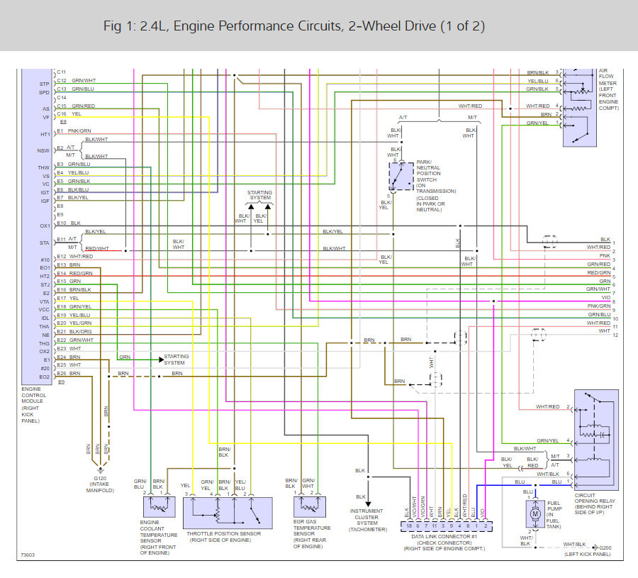

I am not getting any power to the fuel pump. I have checked the pump and it is working and I have also checked the relay and it is also working. What else could this be?
May 31, 2010 at 3:00 AM
BLUELIGHTNIN6
  • 16,542 POSTS

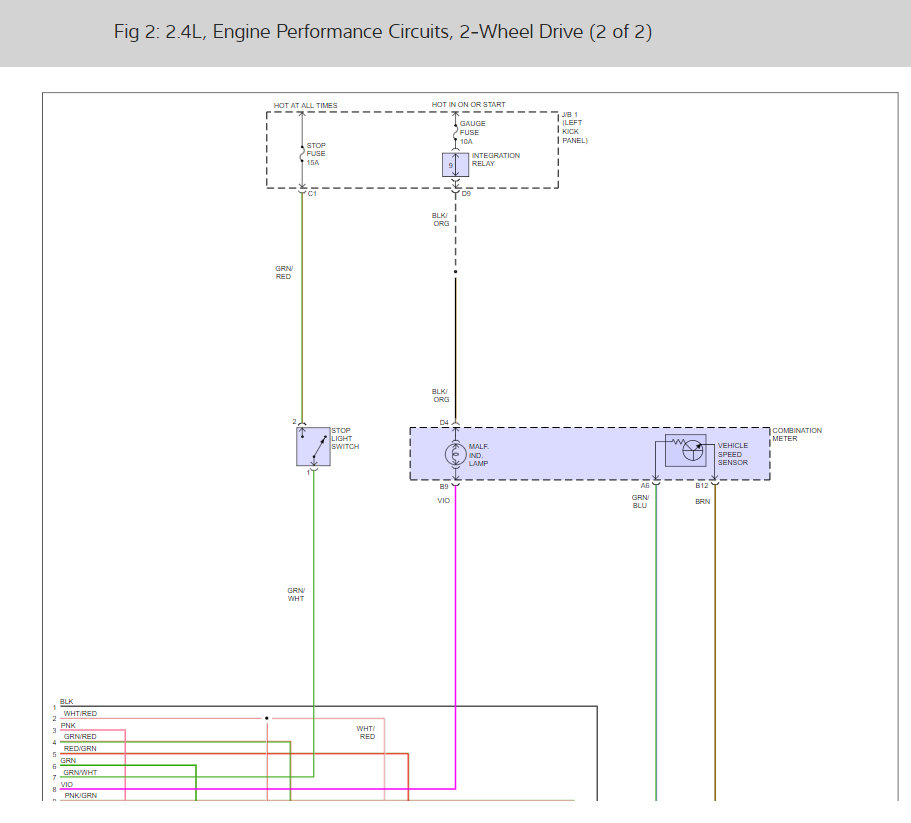

The fuel pump is run by a circuit open relay that you should test. Here is a guide and the fuel pump wiring diagrams so you can see how the system works:
Cheers
May 31, 2010 at 12:09 PM
GREGTHOS
Thank you! It was the relay all fixed.
