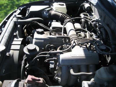

https://www.2carpros.com/forum/automotive_pictures/562724_ToyTacoma1995_1.jpg
I have inserted a picture where it shows the general area of what I think you are talking about. I never remove any of these items. How do I remove this snorkel and then get to this throttle body that you are talking about?

That pipe and hose going across the top of the engine has to be removed so you can get at the throttle plate.
Tuesday, August 17th, 2010 AT 6:45 PM
