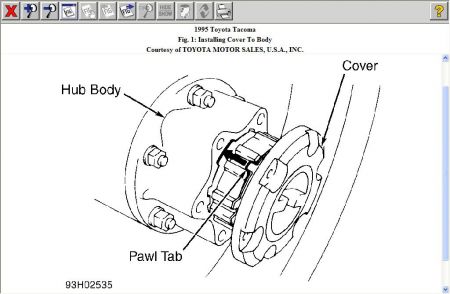

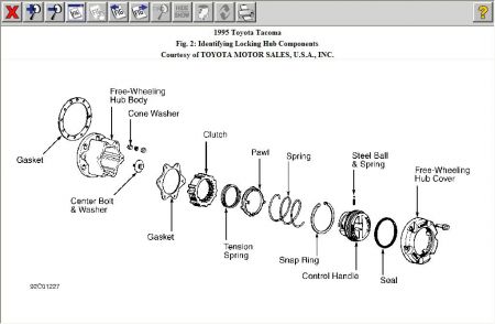

how do you remove the front 4wd axles from this truck i have it unhooked from transfer case i need unhook from the wheelbearing and hub assembly i cant figure out how

Hi josephcraigmyle, The lock hub has to be removed and behind it is a centre lock bolt with washer and a circlip that has to be removed. Removal Set control hub to FREE position. Remove cover bolts and cover. See Fig. 2 . Remove center bolt and washer. Remove hub nuts and washers. Using a brass drift, tap end of each stud to remove cone washers. Remove hub body and gasket. Remove circlip.
https://images.2carpros.com/forum/automotive_pictures/192750_LockHub95Tacoma_1.jpg
When installing, take note of following.
https://images.2carpros.com/forum/automotive_pictures/192750_LockHub95Tacoma01_1.jpg
