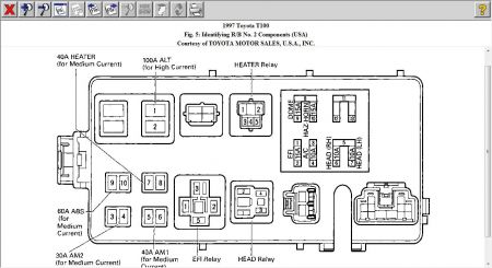

My truck died while going down the road. Upon replacing a blown 15amp fuse, it will restart and be driveable with no problems for a short distance, but blows the fuse again. I don't have an owner's manual, so I can't tell exactly what the fuse goes to. Motor turns over with blown fuse but won't start. What is the problem?

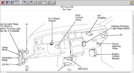

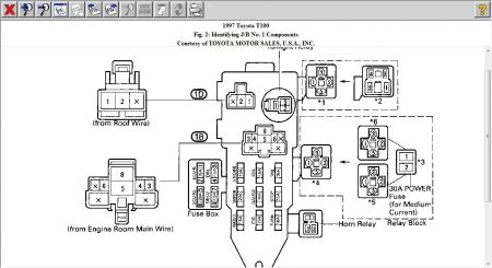

Its gonna be tough with this one -look below is it one of these fuse
https://images.2carpros.com/forum/automotive_pictures/12900_fuse_block_4.jpg
https://images.2carpros.com/forum/automotive_pictures/12900_fuse_block_2_1.jpg
Jan 22, 2009 at 5:46 PM
YOURMOM
Hard to read, but I couldn't find one at all on the i-net! The bottom diagram should represent the box under the hood and it would be the fuse labled EFI.
Jan 22, 2009 at 5:52 PM
  • 75,992 POSTS
I want you to remove the circuit opening relay-replace the EFI fuse-did it blow
https://images.2carpros.com/forum/automotive_pictures/12900_cor_2.jpg
