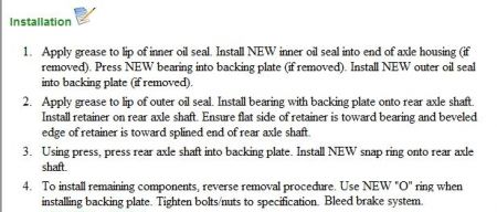

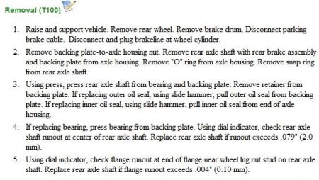

1997 Toyota T-100 bent right rear axle
1997 TOYOTA T-100
LSLEGEND
Drive Train Axles Bearings problem
1997 Toyota T-100 6 cyl Four Wheel Drive Automatic 85K miles
I need information on procedure for removing this axle, I mainly don't know if there is a keeper ring on the axle inside the differential. thanks

https://images.2carpros.com/forum/automotive_pictures/261618_Noname_2275.jpg
https://images.2carpros.com/forum/automotive_pictures/261618_2_111.jpg

THANKS SO MUCH, YOU ANSWERED ALL MY QUESTIONS ABOUT THIS TASK AND YOUR GUIDANCE WILL MAKE EASY TO CHANGE THIS AXLE. GOOD JOB! LARRY
