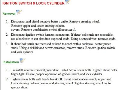

1995 Toyota T-100 6 cyl Two Wheel Drive Automatic
I have to replace the entire ignition switch assemble and I can not figure out how to get it out. It seems that the gear rod? is in the way. And I seem to have lost my a/c blower wipers and I did connect the new one, but it did not start up. I know it work because I did get the tone from the key being in the ignition.
Honestly any advice would be appreciated, r if you know of an online manuel.
Thanks
Phil

https://images.2carpros.com/forum/automotive_pictures/261618_Noname_2276.jpg
