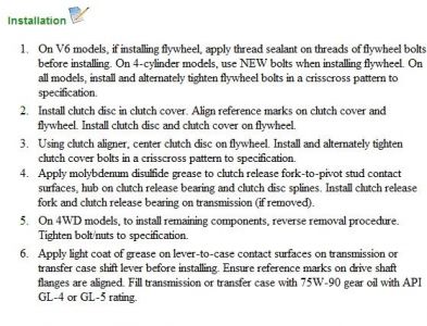

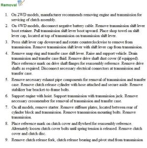

Can you please give me insturctions as to how to install a clutch fork on this Toyota truck?

https://images.2carpros.com/forum/automotive_pictures/261618_Noname_2277.jpg
https://images.2carpros.com/forum/automotive_pictures/261618_Noname2_746.jpg
