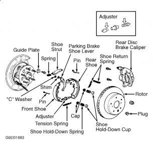

Shakes or Wobbles problem
1994 Toyota Supra Two Wheel Drive Manual 110000 miles
I can not take off the disc. Is any lock beside of the nut is in the middle . please let me know. thanks
Aug 16, 2009 at 5:42 AM
DOCFIXIT
  • 18,828 POSTS
Parking brake shoes holding rotor on. Slot in backing plate back off star adjuster. rotor will pull off.
https://images.2carpros.com/forum/automotive_pictures/198357_Graphic_67.jpg
