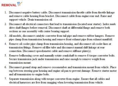

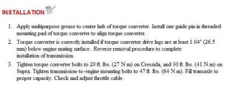

how do you put in a supra transission
Mar 6, 2010 at 1:12 PM
BLUELIGHTNIN6
  • 16,542 POSTS
https://images.2carpros.com/forum/automotive_pictures/261618_Noname_2017.jpg
https://images.2carpros.com/forum/automotive_pictures/261618_Noname2_652.jpg
