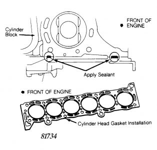

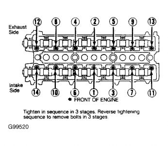

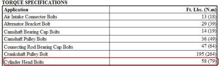

I have heard that these 7mge engines are knows to blow head gaskets because the manufacturer did not torque the head gaskets tight enough. Can I torque them tighter to prevent this? And to what torque and how would I go about this project?

Below are the proper specs. and gasket placement..
https://images.2carpros.com/forum/automotive_pictures/261618_Noname_477.jpg
https://images.2carpros.com/forum/automotive_pictures/261618_1_60.jpg
https://images.2carpros.com/forum/automotive_pictures/261618_2_38.jpg

I see that these are the manufacturers suggested torques. My question is that I have read that these manufacturers torques are not tight enough, and that the head gaskets bolts need to be torqued higher. Do you know what the new torque should be? and how would I go about this? Thanks

There is no recalls or technical service bulletins for this vehicle about cylinder head torque..My sources are up to date and direct from dealer repair manual. Tightening the bolts more than dealer specs is completely your decision and your call on what to torque it to beyond this. You would need a torque wrench to perform the operation.
User note: Toyota, not big on recalls. All these engines were meant to be 85 ft lbs. Somewhere an error occurred in the oem specifications. Look it up on Wikipedia Thanks
