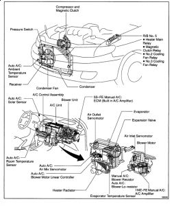

The blower motor only works on the "High" setting. How can I fix it?
Wednesday, March 24th, 2010 AT 4:11 PM
MECHANIC
75,992 POSTS
Replace the blower motor resistor.See diagram below:
