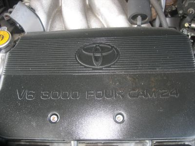

1999 Toyota Solara 6 cyl 160000 miles
there is oil leaking I think from my enginge? Someone told me it needed a new gasket. How much would that cosst with labor?

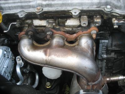

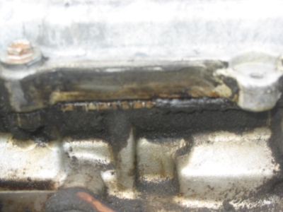

Thank you for VERY promt reply. Seems that th leak is coming from where the front of the engine where is screwed together. It is the SLE V6 so there is like a fold there in the frnt and it seems a bit of oil is lining where that fold is.

REKOSAINT
  • 6 POSTS
plus they say a picture is worth a thousand words maybe this help too
https://images.2carpros.com/forum/automotive_pictures/381384_IMG_2228_1.jpg
https://images.2carpros.com/forum/automotive_pictures/381384_IMG_2229_1.jpg
https://images.2carpros.com/forum/automotive_pictures/381384_IMG_2226_1.jpg
Jul 13, 2009 at 4:02 AM
MHPAUTOS
  • 31,937 POSTS
HI there,
That pic is the rocker cover, they do leak often and may be the point of your problem, the front one is fairly easy to replace, but the inlet manifold must be removed to access the rear one, this will be a job for your mechanic,
