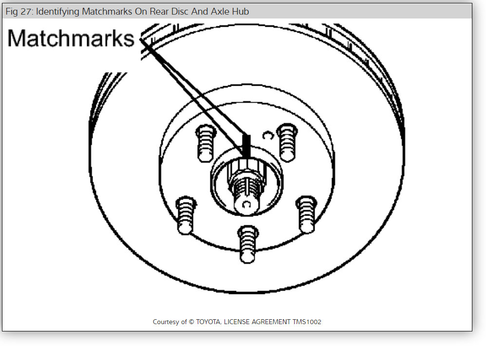

Hi jegaudette, Here are the procedures DISASSEMBLY 1. REMOVE REAR WHEEL 2. SEPARATE REAR DISC BRAKE CALIPER ASSEMBLY LH HINT: Do not disconnect the flexible hose from the brake caliper. 3. REMOVE REAR DISC a.Release the parking brake, and remove the rear disc. HINT:  Align matchmarks on the disc and the axle hub.  If the disc cannot be removed easily, turn the shoe adjuster until the wheel turns freely.
https://images.2carpros.com/forum/automotive_pictures/192750_RearBRakeComp09SiennaFig19_1.jpg
https://images.2carpros.com/forum/automotive_pictures/192750_RearBRakeComp09SiennaFig18a_1.jpg
If rotor is stuck, use 2 pcs of 8 X 1.25 ( m8 ) bolt to slowly tighten into the red dots in diagram to pull the rotor out. Ensure both bolts are turned in evenly ands avoid excessive force. After installation, the park brake shoes have to be adjusted. ADJUST PARKING BRAKE SHOE CLEARANCE a.Temporarily install the hub nuts. b.Remove the hole plug, and turn the adjuster and expand the shoes until the disc locks. c.Contract the shoe adjuster until the disc can rotate smoothly. Standard: Return 8 notches d.Check that the brake disc rotates smoothly. e.Install the hole plug.

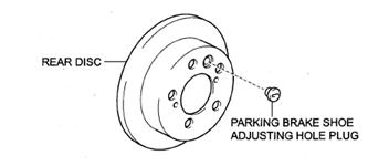

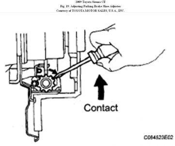

CBAUDER
how do I collapse the parking brake so I can remove the disc with the internal parking brake drum?
Sep 29, 2019 at 11:47 AM (Merged)
BLUELIGHTNIN6
  • 16,542 POSTS
remove plug from the disc to access the parking brake shoe adjuster

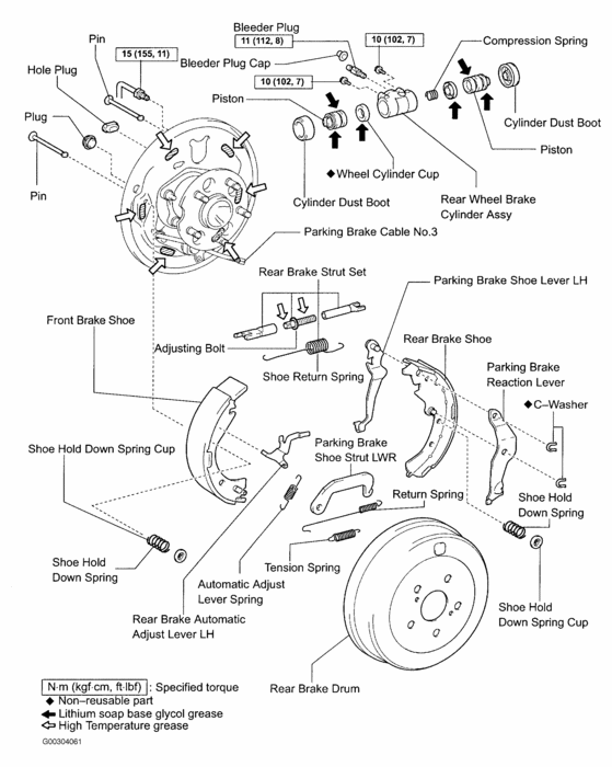

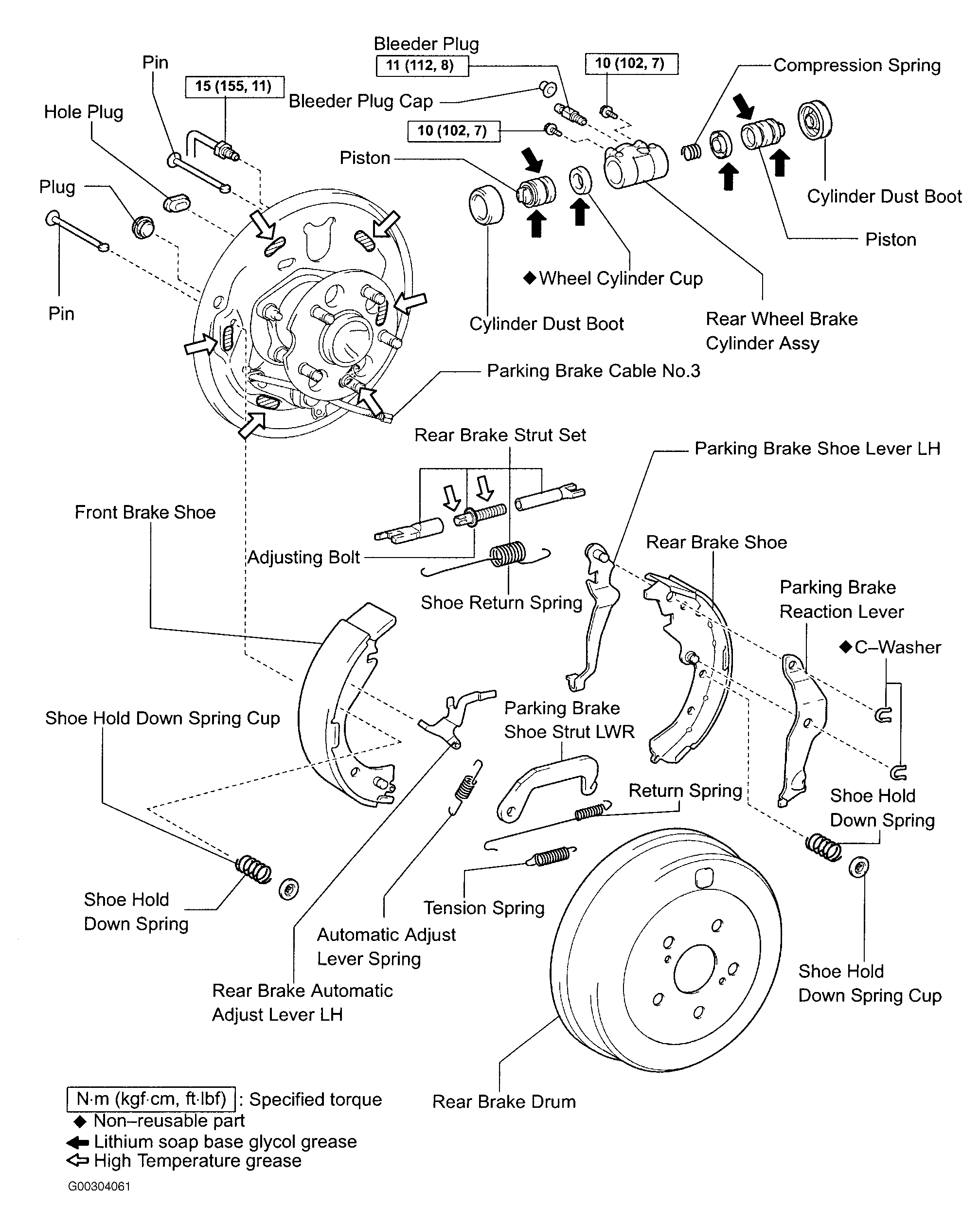

AKHAN64
I have 2004 Toyota Sienna front wheel drive, I have the same problem. I cannot remove the old rear rotor from axle. As per the previous discussion I understand, it has a lock. The rotor has a hole and it was covered with rubber cap. I removed the rubber now I could see inside. I checked there are four cog/gear instead rotor. They all on different position makes letter ‘X’ (2, 4, 8 and 10 o’clock).
Can somebody paste picture or video to help me how to un-screw and remove the rotor. I tried a lot, but could not succeed. It is very difficult the insert any screw driver inside the rotor via hole (hole is small). Which type of screw-driver should be used? I don’t think it could be possible with common screw drive. Common screw does not contain same number of teeth as cog has.
DOCFIXIT
  • 18,828 POSTS
If rotor after caliper is removed it pulls off. if drum then maybe nesessary to remove plug in backing plat and use screwdriver to backoff star adjuster

AKHAN64
What is the position of star adjuster when you are facing to drum. Is star teeth facing to you in vertical position like to see car's tire from back or front?
How to search by moving drum? In which position I have to bring drum hole in order to see the star adjuster?
DOCFIXIT
  • 18,828 POSTS
12o,clock
AKHAN64
Thanks dear, it is exactly on 6 O'clock position.
DOCFIXIT
  • 18,828 POSTS
Must have watch on upside down
