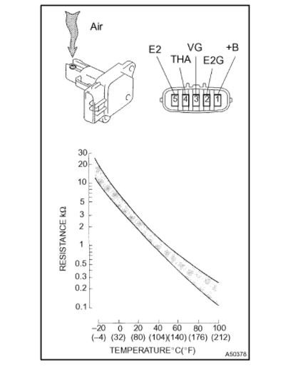

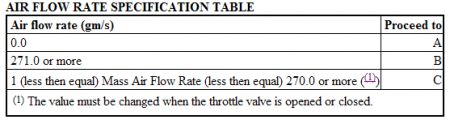

INSPECT MASS AIR FLOW METER
a. Output voltage inspection.
1. Apply battery voltage across terminals 1 (+B) and 2 (E2G).
2. Connect the positive (+) tester probe to terminal VG, and negative (-) tester probe to terminal E2G.
3. Blow air into the MAF meter, and check that the voltage output fluctuates.

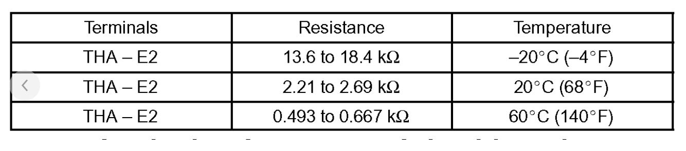

b. Resistance inspection.
1. Using an ohmmeter, measure the resistance between terminals 4 (THA) and 5 (E2).

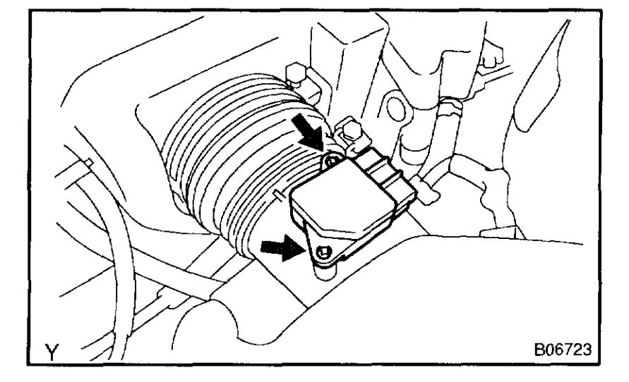

I was just wondering on my specific vehicle model is the location of my MAF sensor?
Thank you
Feb 24, 2021 at 11:50 AM (Merged)

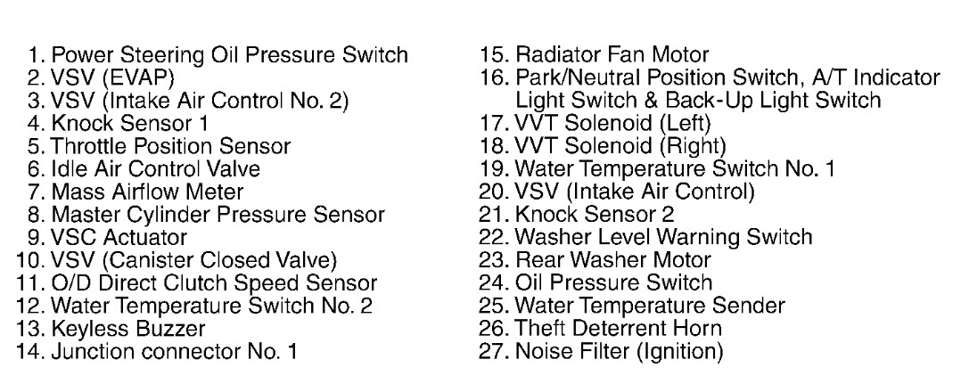

Good morning,
I attached the location of the sensor below for you.
https://www.2carpros.com/articles/how-a-mass-air-flow-sensor-works-maf
https://www.2carpros.com/articles/how-to-replace-a-mass-air-flow-sensor-maf

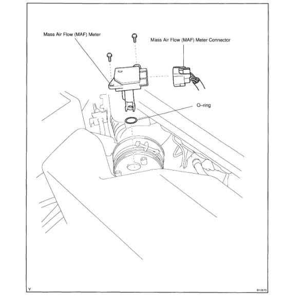

REMOVE MAF METER
a. Disconnect the MAF meter connector.
b. Remove the 2 screws, MAF meter and O-ring.
HINT: At the time of installation use a new O-ring.
INSTALLATION
Installation is in the reverse order of removal.

OLDCATJR

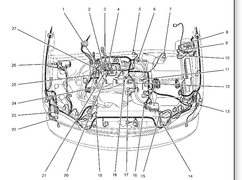

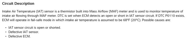

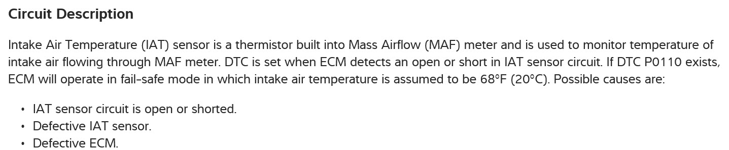

I have a 0110 OB2 code and have replaced the MAF. some tell me the IAT and MAF are one and some say there is a separate IAT.
Feb 24, 2021 at 11:51 AM (Merged)
HMAC300
  • 48,601 POSTS
You do not have an IAT only a MAF which is part of an assembly/duct work. Check out the diagrams (Below). Please let us know if you need anything else to get the problem fixed.
