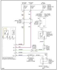

after changing a brake lamp I realized taht I now have no brake lights at all. also the transmission will not engage out of park without extra force. I believe there is a connection between the brake pedal and the rear lights that has been disrupted somehow.
would this cause this to trigger a lock on the transmission and are the two problems possibly related due to an electrical malfunction? Is this something I can trace or does this need to go to the dealer?

Fair chance the brake light switch is bad. IT could affect both issues. Check the connector while testing it.
https://images.2carpros.com/forum/automotive_pictures/30961_si_1.jpg
