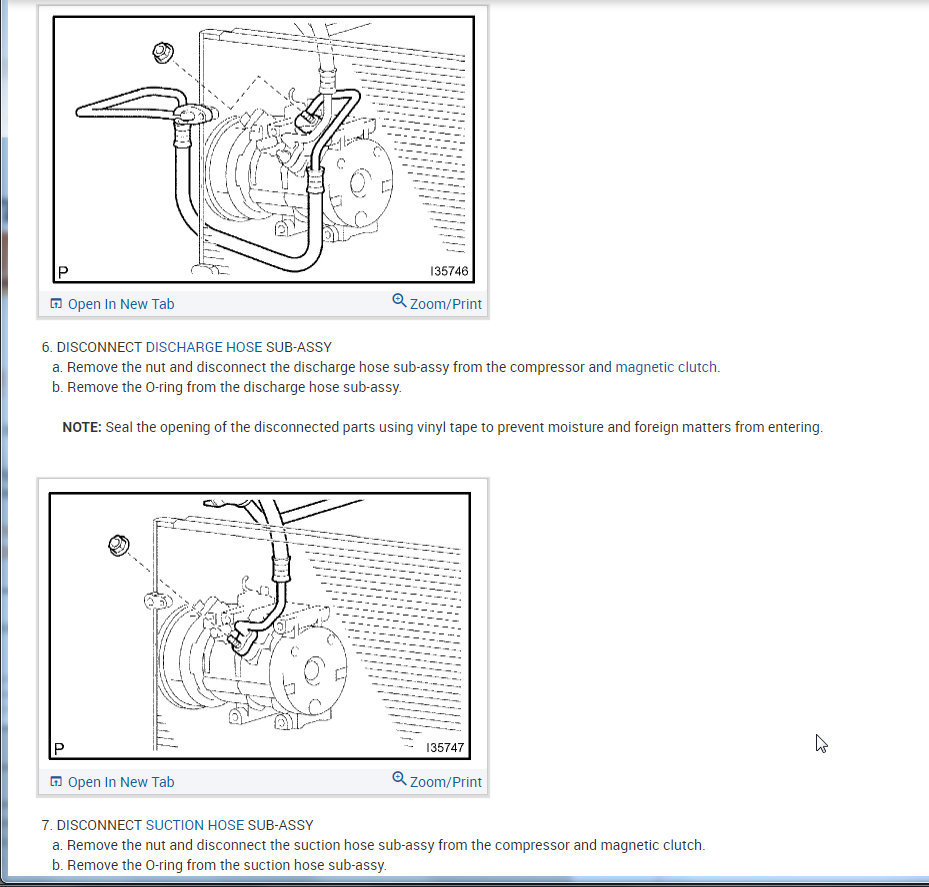

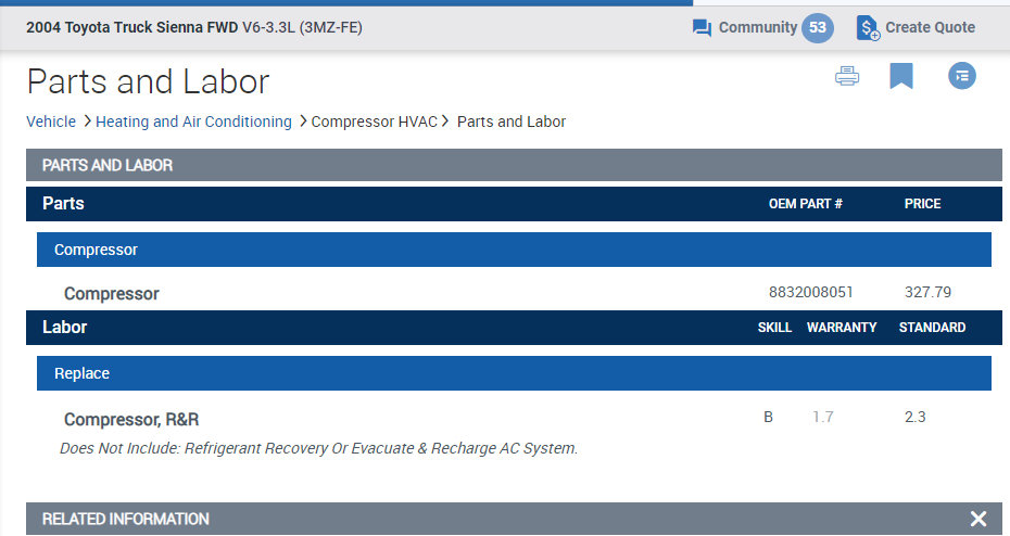

rebuilt a/c compressor is this okay to use to fix an air conditioning unit that also requires an Expansion valve. What is the cost to fix this? We were charged $5100 which is outrageous. What is the cost to fix an a/c unit + expansion valve? Is there a place online to get estimates on the weekend.
Aug 21, 2009 at 5:44 PM
This does not sound right as the compressor is about $350 to replace so I am not sure what would be more then $5,000.00. Unless they are replacing the entire system including the lines, I don't think that is something I would pay for.

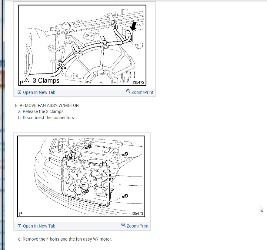

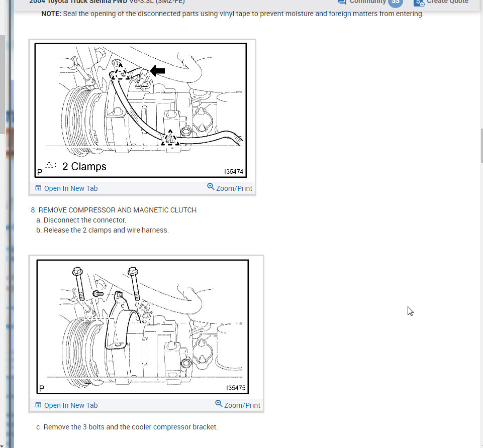

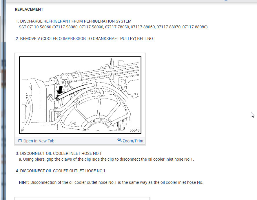

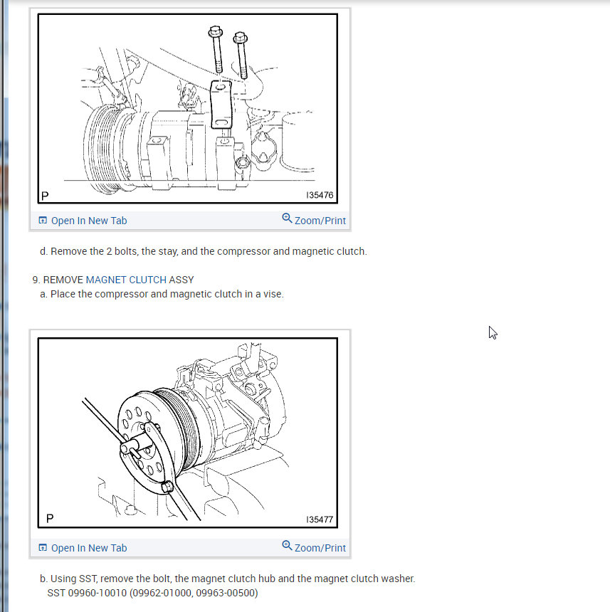

The expansion valve does not change the repair if the compressor needs to be replaced so I would seek a second opinion based on this info.
Here are some guides that will help with this replacement:
https://www.2carpros.com/articles/replace-air-conditioner-compressor
Let's run through the attached info below and let us know if you have questions. Thanks
