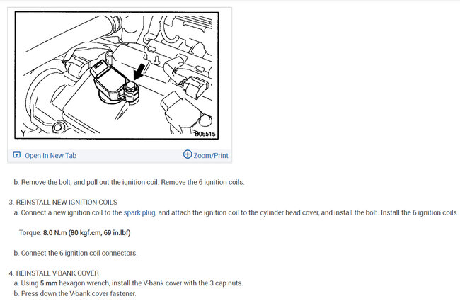

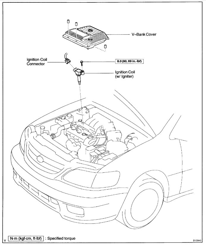

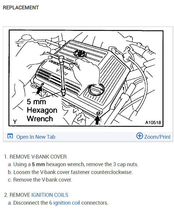

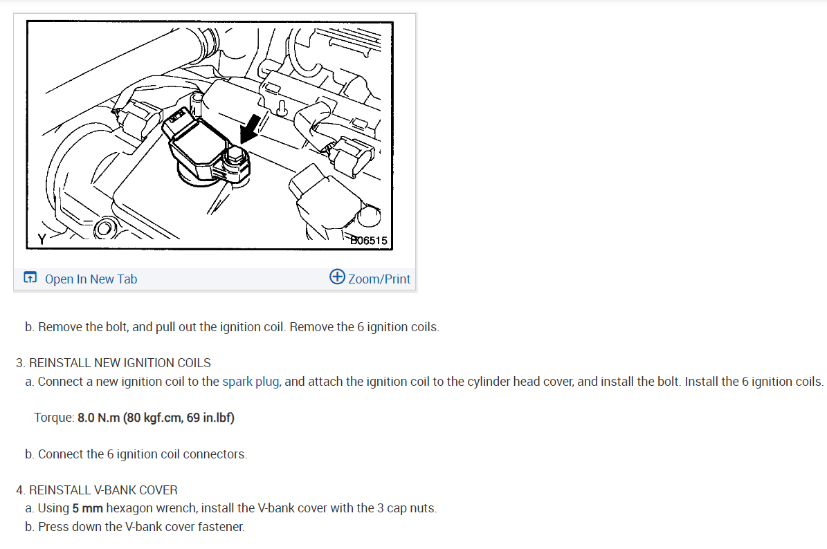

Yes, you can do the job yourself, here is a guide to help and I have included more intrusions in the images below.
https://www.2carpros.com/articles/how-to-change-spark-plugs
Recommended Spark Plug
DENSO .................... SK20R11
NGK .................... IFR6A11
Here are the instructions including torque specs. Check out the images (below). Let us know if you need anything else.
