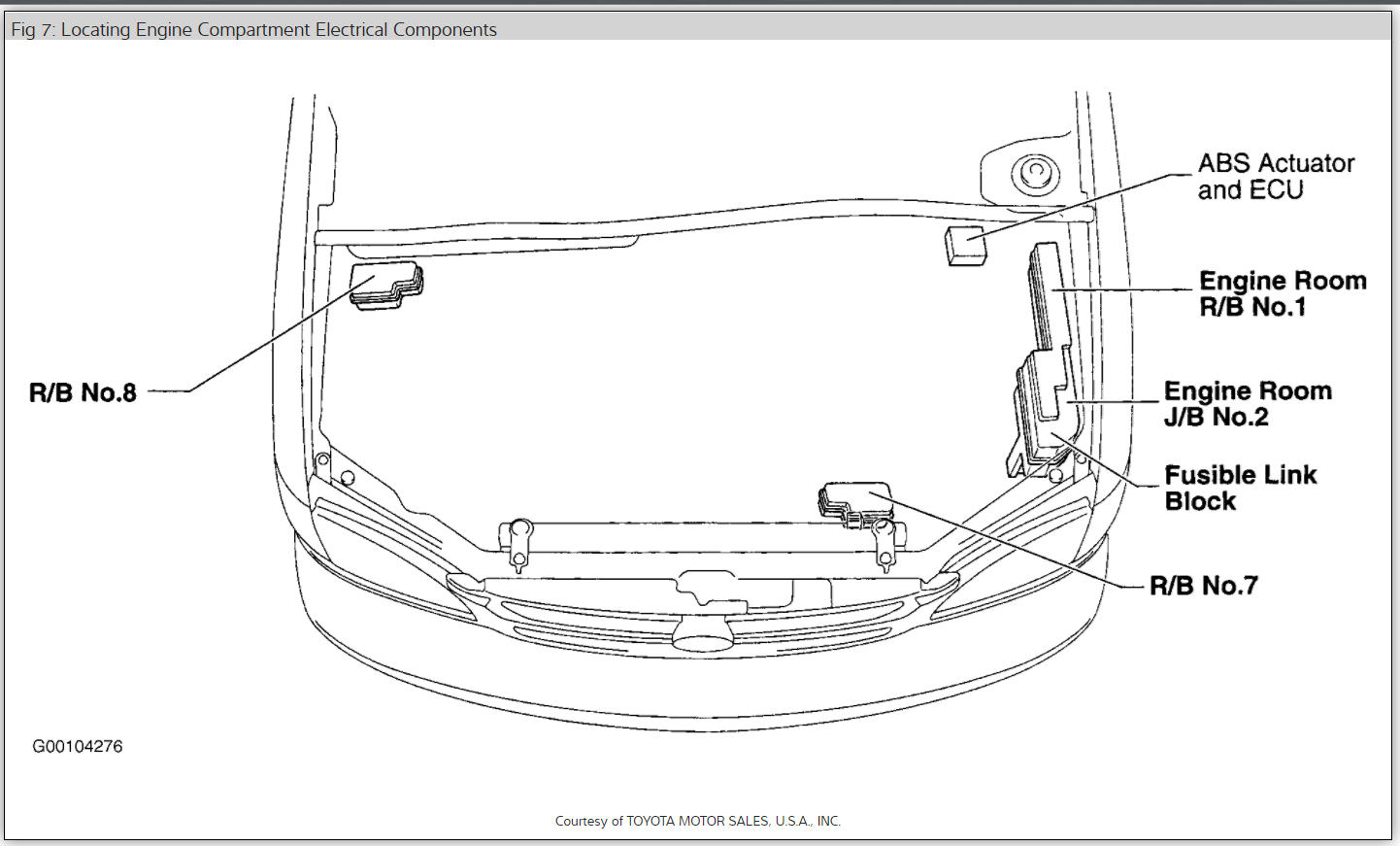

1. The remote does not work at all 2. The power lock button on the driver and passenger doors do nothing when pushed unless the key is turned on 3. Interior lights do not work at all 4. Clock built into dash does not light up Could it be a fuse? All of this appeared to occur at once within the last day. My wife tells me the temperature/compass reading in the rear-view mirror acted up in the last day or so but since then has cleared up (99 DegF here in the day)
Aug 3, 2010 at 2:42 PM
DOCFIXIT
  • 18,828 POSTS

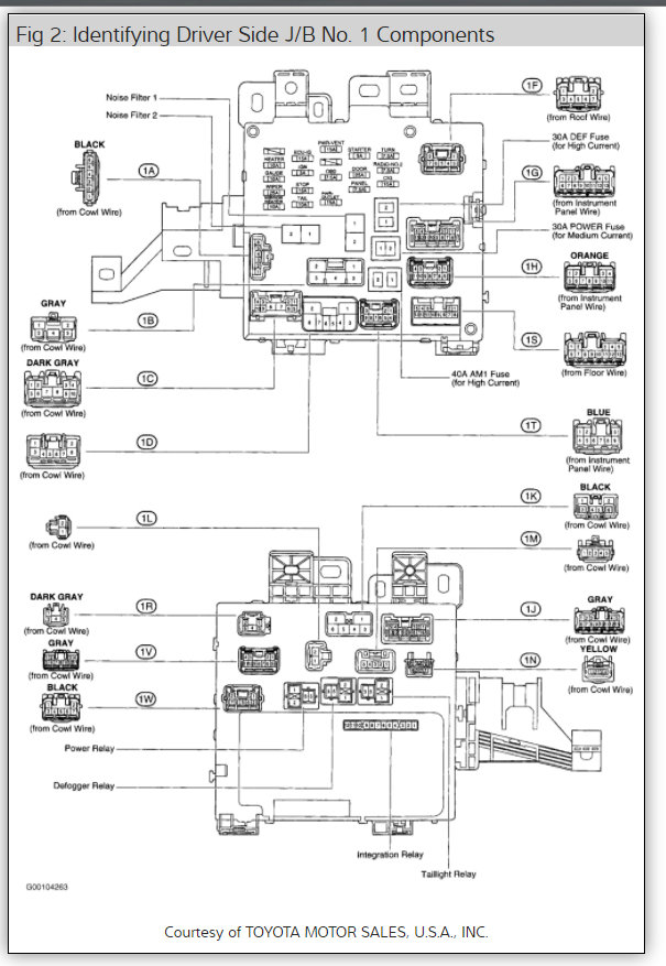

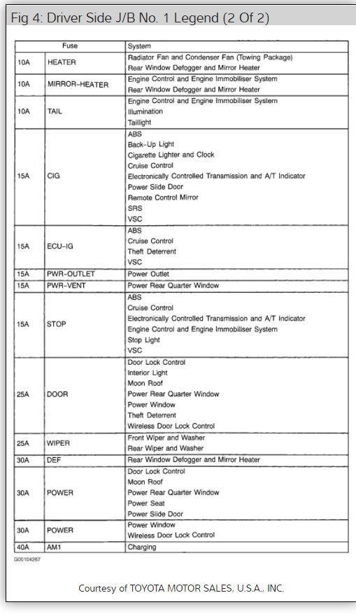

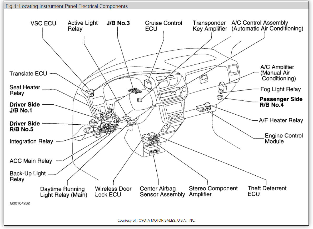

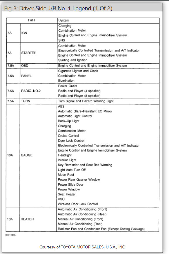

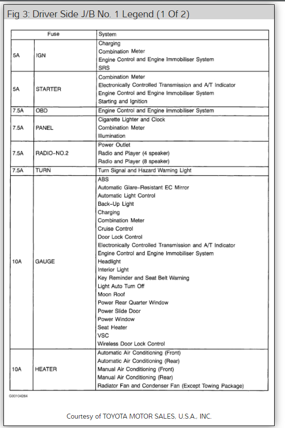

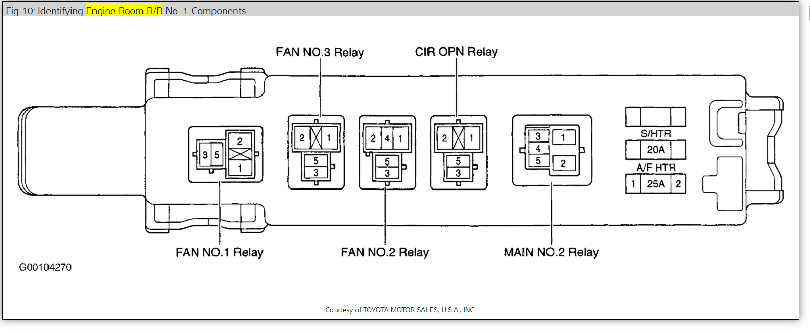

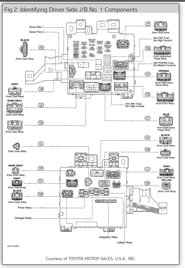

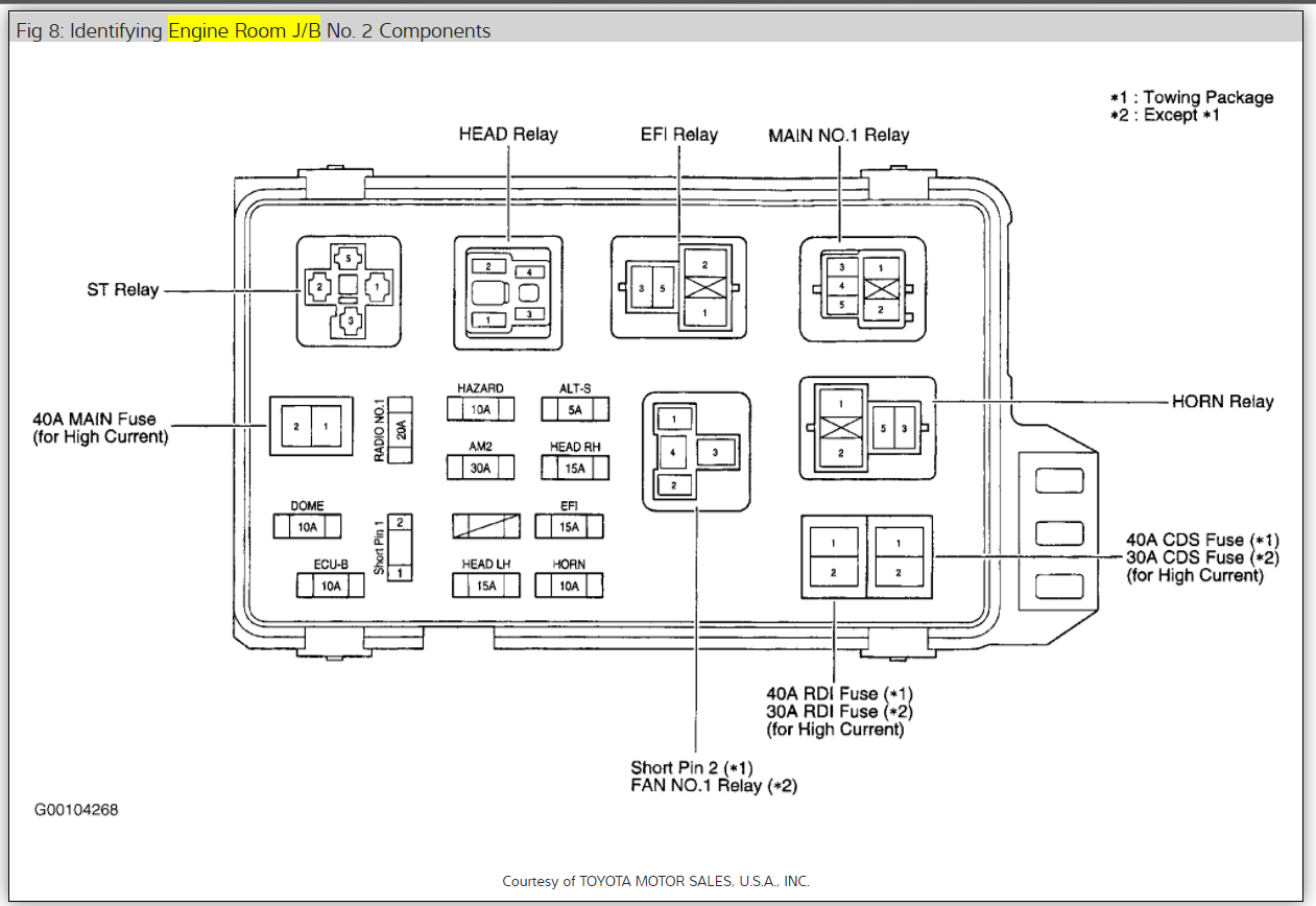

It sounds like a door lock fuse please check the fuses by following the is guide.

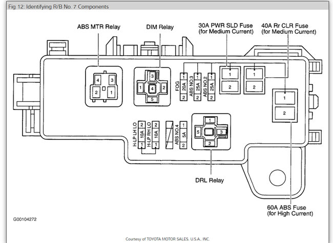

Here are the fuse panel locations. Check out the diagrams (Below) Please run this test and get back to us.
Apr 12, 2021 at 10:24 AM
SEHENRY2000
  • 7 POSTS
Bought a tester and 10 amp fuse for "Gauge" is OK. Other ideas?

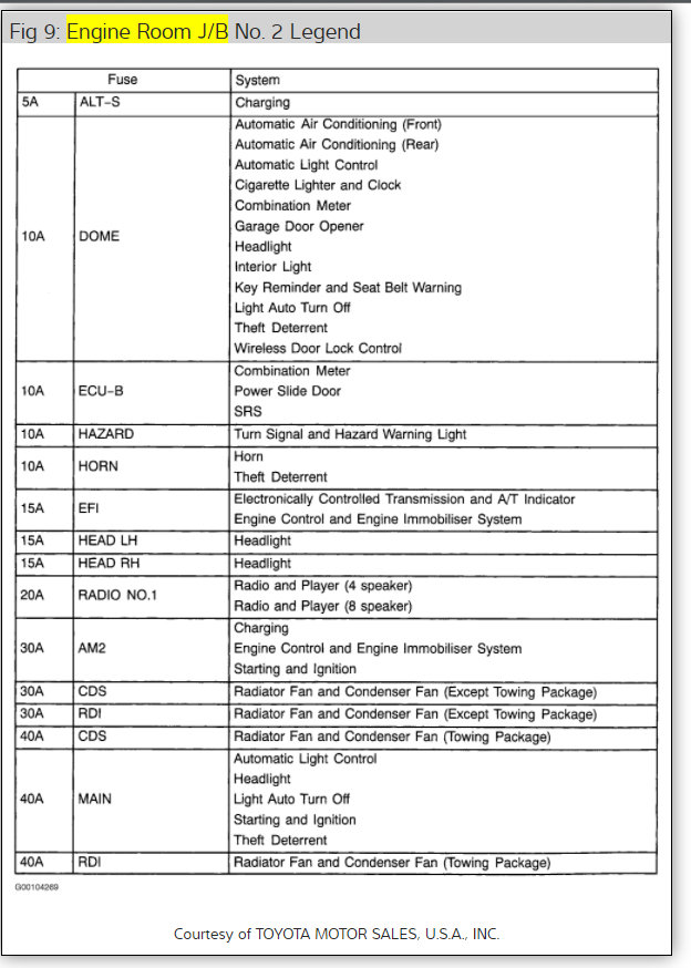

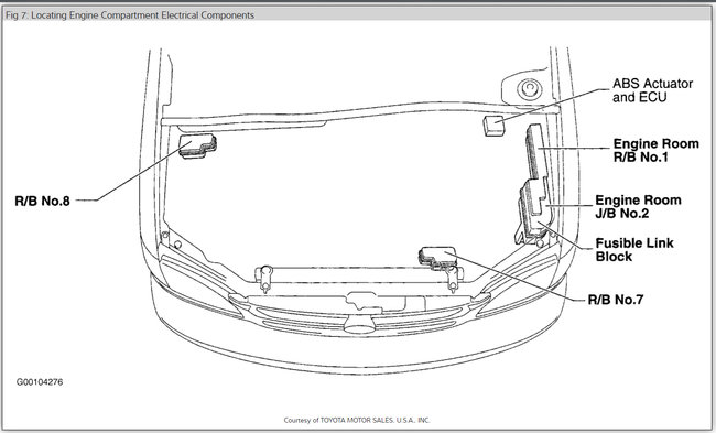

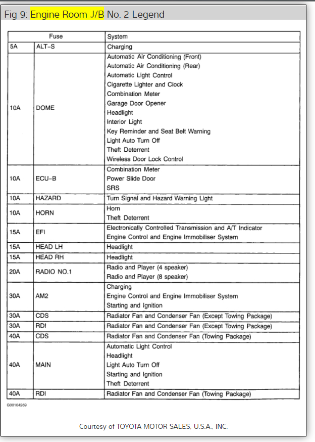

BEVEYBS, it is probably the 10 amp dome fuse underneath the hood in the long fuse box beside the battery.
NOVEMBER263
I had the same problem with my 2000 Sienna. The remote door fob unlock/lock would not work and the door lock/unlock switch inside the car on the driver’s armrest would not work with the car turned off.
The blown fuse was under the hood in the fuse/relay box on the drivers side. The 10 amp fuse was labeled dome lights. There is a row of 3 spare fuses in that fuse box: a 10, 20 and 30 amp. I used the spare 10 amp fuse. Problem fixed.
