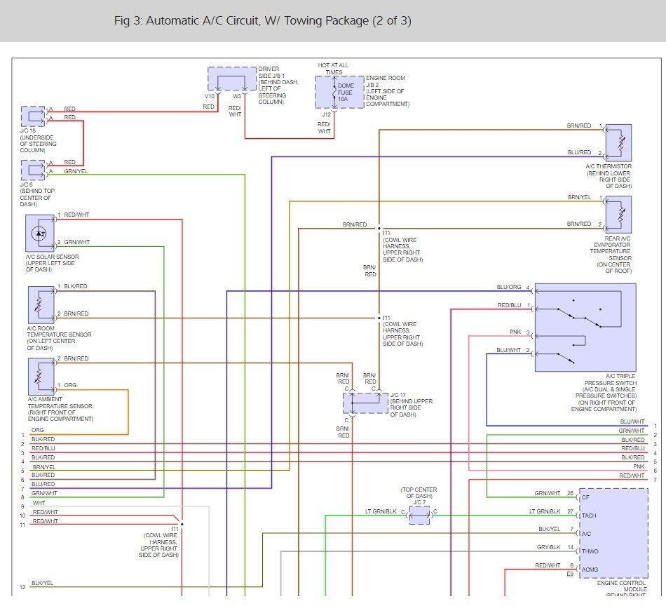

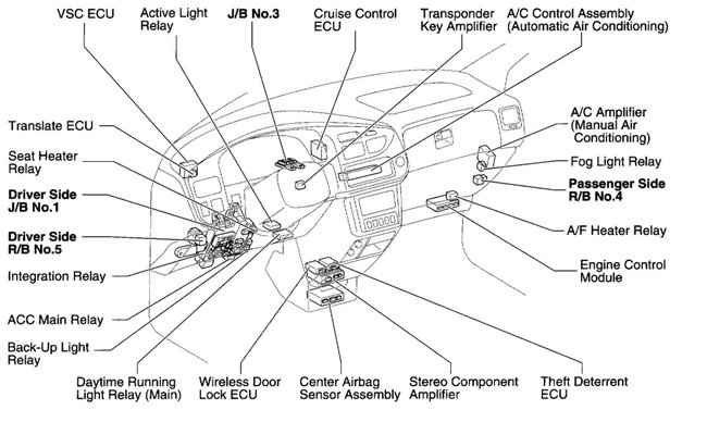

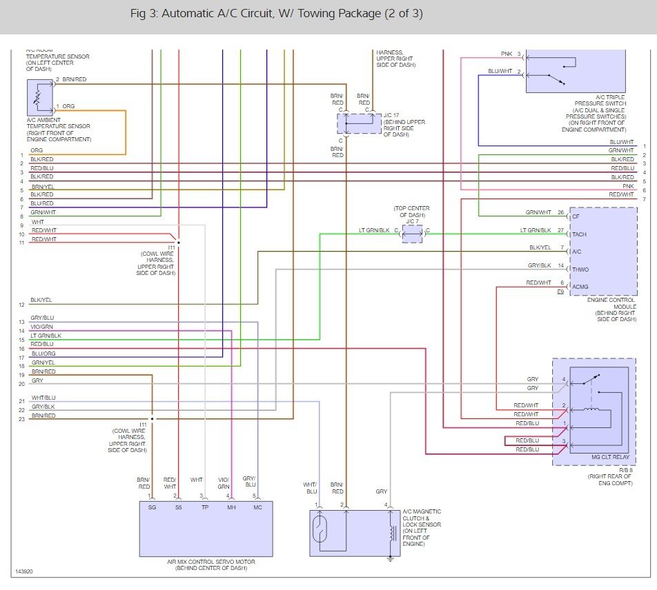

Air Conditioning problem 6 cyl Two Wheel Drive Automatic
Can you tell me where the air conditioner relay is located please?
You guys are great btw :)
Aug 15, 2010 at 10:10 AM
  • 55,423 POSTS
It looks like it is on the passengers side either near the foot well or just inside the engine compartment on the same side. Here is a diagram (below) of its location and the wiring diagram which can help you test the wiring and a guide to help test the relay.
