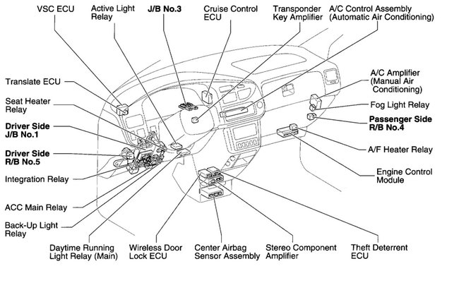

Can you tell me where the air conditioner relay is located please?

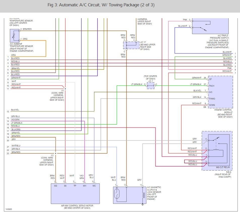

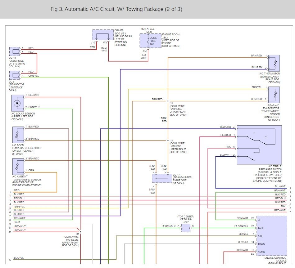

It looks like it is on the passengers side either near the foot well or just inside the engine compartment on the same side. Here is a diagram (below) of its location and the wiring diagram which can help you test the wiring and a guide to help test the relay.
