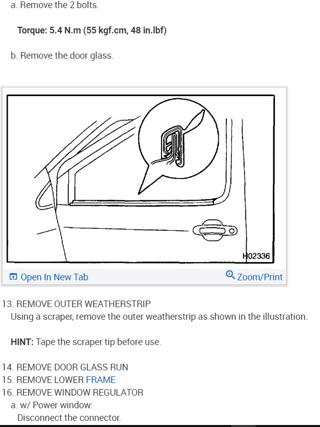

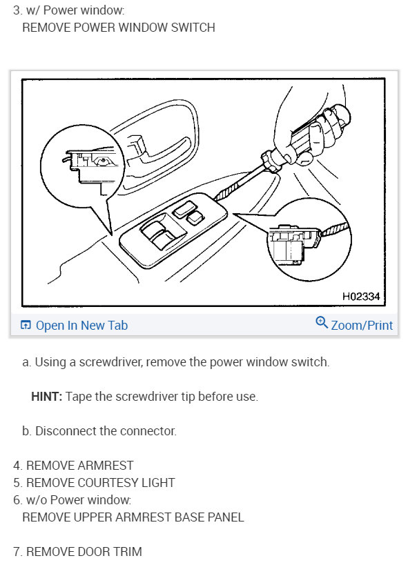

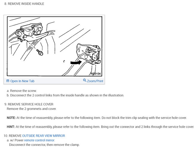

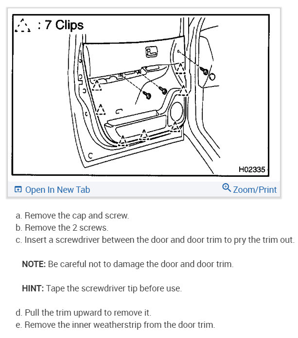

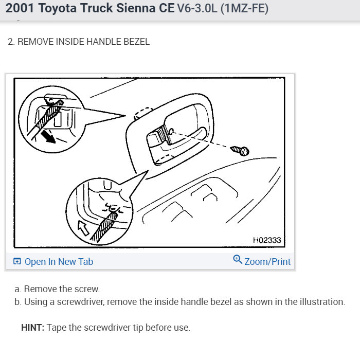

It need to be replace as unit you must remove the inner door panel to replace the mirror here is a guide to walk you through and instructions on you car below.
Removal & Installation
Remove door inside trim panel. Door inner trim panel may include speaker. If necessary, disconnect speaker harness connector. Disconnect power mirror motor harness connector. Support outside mirror assembly while removing mirror retaining bolts/nuts on inside of door. To install, reverse removal procedure.
https://www.2carpros.com/articles/door-panel-removal
