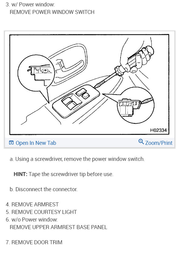

Hi. My driver side view mirror - power, lost its locking mechanism. The mirror moves loosely and cannot stay in one position. What happen, per my 16 y/o son was he tried moving the mirror towards the vehicle and heard a popping sound. I took the bottom 3 screws from the housing unit and also from the doors. I could see the ball bearing inside the housing unit of the mirror as well as the 2 plates that locks the mirror together. When I tried pulling the plate that is connected to the mirror, it seems that the locking mechanism is loose. Here are my questions: Do I need to change the whole housing unit or can I take it apart and see if I can fix the spring in the unit. Or, if I need to buy a unit, how do I change it. Thank you for your help.

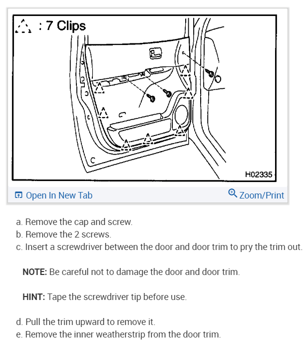

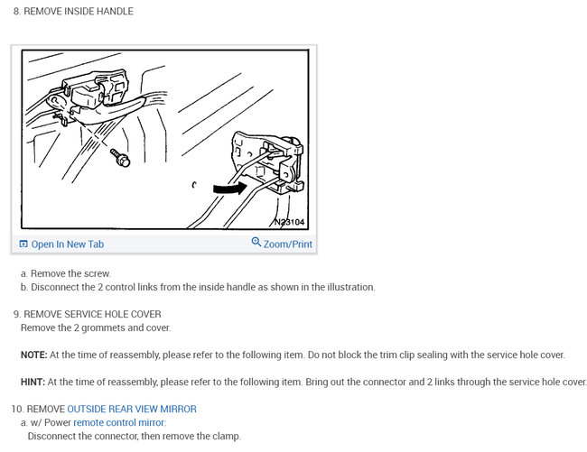

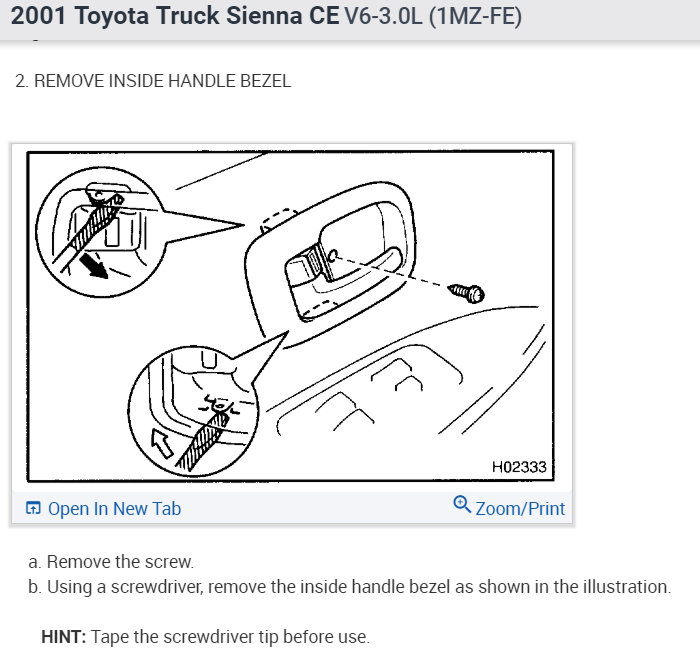

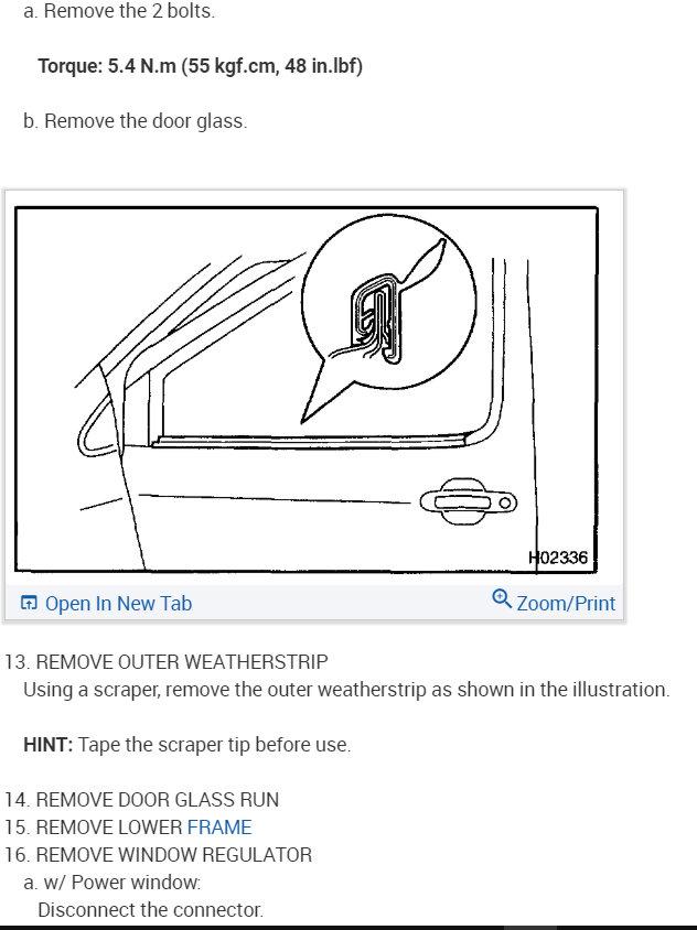

It need to be replace as unit you must remove the inner door panel to replace the mirror here is a guide to walk you through and instructions on you car below.
Removal & Installation
Remove door inside trim panel. Door inner trim panel may include speaker. If necessary, disconnect speaker harness connector. Disconnect power mirror motor harness connector. Support outside mirror assembly while removing mirror retaining bolts/nuts on inside of door. To install, reverse removal procedure.
https://www.2carpros.com/articles/door-panel-removal
