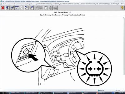

I have check tire pressure for each tire and making them even. However, tire engine light tays on. I have tried reset button but thatdoe not help. What can I do?

AS the owner about all you can do at home is, make sure the brake lights work, the ABS light works, and goes out. Fill the tires to the recommended pressure, all tire must be the same size and good tread. Then to initialize the system, press and hold the tire pressure warning standardization switch and hold it until the warning light flashes three time, then the vehicle needs to be driven until 18 mph is achieved.
https://images.2carpros.com/forum/automotive_pictures/62217_TirePressureWarna_1.jpg
This needs to be done if you change tires, or one wheel!
