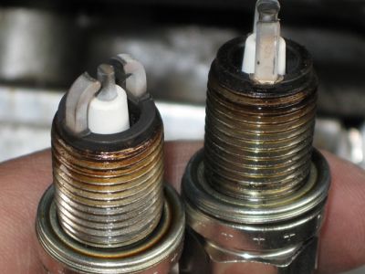

Well that just depends on how it persists. I have seen engines last years this way. If you like include a pic of the plugs and the smoke if you can catch that and I will look at them and let you know what I think. Thanks.

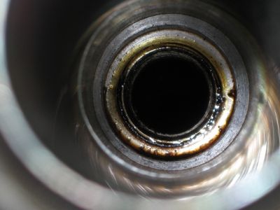

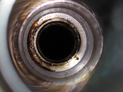

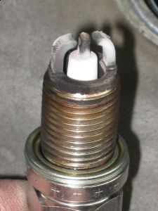

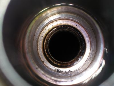

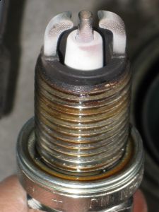

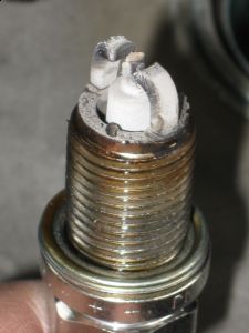

https://images.2carpros.com/forum/automotive_pictures/337098_36193606_007_1.jpg
https://images.2carpros.com/forum/automotive_pictures/337098_36193606_010_1.jpg
I attached the coolant photos to you too. After I changed the new coolant /antifreeze last 2 weeks(June 14th) I mark the level of it with the black line(it's above the word "full"). From that day till June 19th I drove around 180 miles and the coolant level drop to the orange line. And from June 19th to today(June 22nd) I drove about 300 miles and I notice that the coolant level drop to its current level as you see in the attached photo.
https://images.2carpros.com/forum/automotive_pictures/337098_36193606_011_1.jpg
https://images.2carpros.com/forum/automotive_pictures/337098_36193606_012_1.jpg
https://images.2carpros.com/forum/automotive_pictures/337098_36193606_013_1.jpg
These 3 pics are the front spark plugs from left to right.
https://images.2carpros.com/forum/automotive_pictures/337098_36193606_009_1.jpg
This pic is the rear spark plugs.
https://images.2carpros.com/forum/automotive_pictures/337098_36193606_014_1.jpg
https://images.2carpros.com/forum/automotive_pictures/337098_36193606_015_1.jpg
https://images.2carpros.com/forum/automotive_pictures/337098_36193606_016_1.jpg
These 3 pics are the holes of front spark plugs from left to right. Sorry that I can't take the photo of the smoke for you. Yesterday it came a little bit after I start the engine after driving around 25 miles
Jun 22, 2009 at 3:35 AM
RACEFAN966
  • 5,029 POSTS
Well the plugs look like they have coolant deposits on them. So what I would do is find a shop that will do a chemical test on the engine. What they will do is put a tub on the radiator neck with the cap off and put a chemical in it and if the chemical changes color then you have a blown head gasket. Let me know how this goes.

Not with out the chemical test as this test is what will tell you with no doubt it is a head gasket blown or possible cracked head. You won't know till it is apart. Did they do a pressure test on the radiator to see if it will hold the 16 psi of pressure it should be able to hold? If not they should do that first then do the chemical test if the pressure does hold. It may cost a little now but it will tell you that you are not waisting money to pull head off. I am a mechanic not a parts replacer so I believe in testing and taking out all guess work as I don't like upset costomer because I was wrong.
Jun 24, 2009 at 2:39 AM
BEW
  • 15 POSTS
Today I went to the other shop. The shop did a pressure test and chemical test for me. The pressure test hold 14 psi which the mechanic said it's normal. For the chemical test, it's fine as well. The mechanic said my car has 103225 miles which it's rather high so the engine burns the oil when I drive for a long trip. He suggests that next time when I gonna change engine oil I should use the thicker oil that is 10W30. By the way, after I arrived home today I check the coolant again and I've found that it reaches up to orange line again (please see the pic above). Last 2 days I took the pics in the morning that I hadn't driven anywhere yet. That morning the coolant was under the orange line. What do you think?
Jun 24, 2009 at 2:14 PM
RACEFAN966
  • 5,029 POSTS
That is normal, it will be lower when the car is cold because it will expand and go to the recovery tank when it get warmed up and then pull it back into the radiator as it cools. Well at least you know what is up that would have sucked to spend all that money on a head and find out that it needed a total overhaul. So I would do as the mechanic recomended and use a little heavier oil and see how it does. It will eventually need a new engine or rebuild but I would drive it till it is needed. Have a great day.
