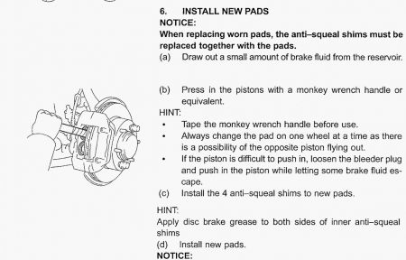

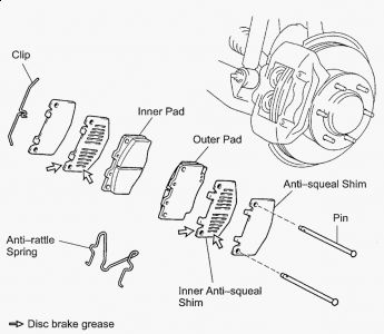

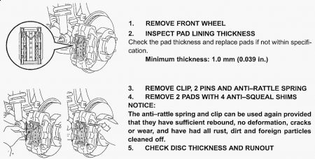

What bolts do you remove to replace the brake pads. I have found 6 so far and don't want to just start guessing.
