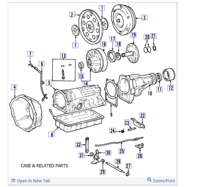

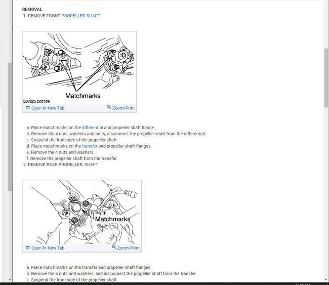

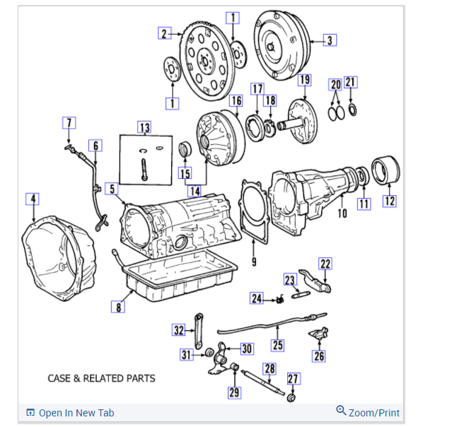

I have a Toyota Sequoia it has a leak on the rear transmission seal. I had the drive line repaired and replaced both u-joints. I have replaced the seal two times and it still leaks. i don't know what to do?
Mar 17, 2010 at 4:20 PM

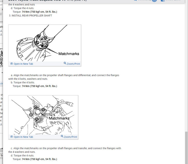

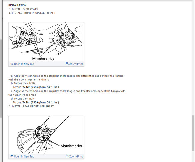

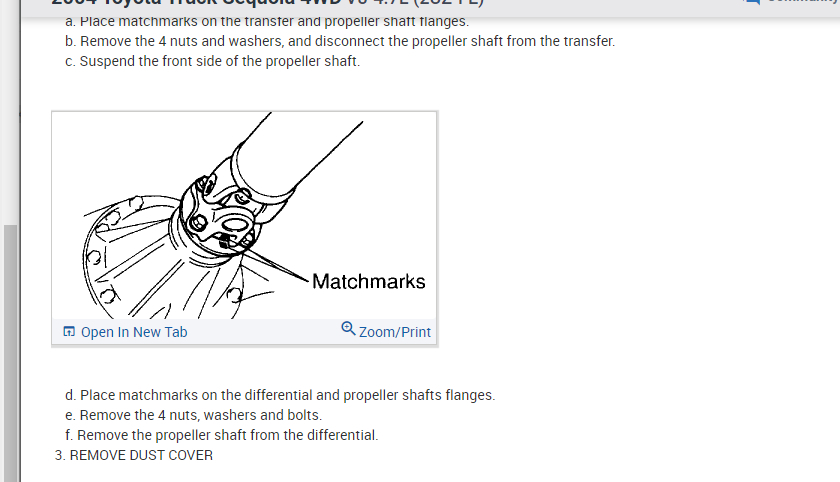

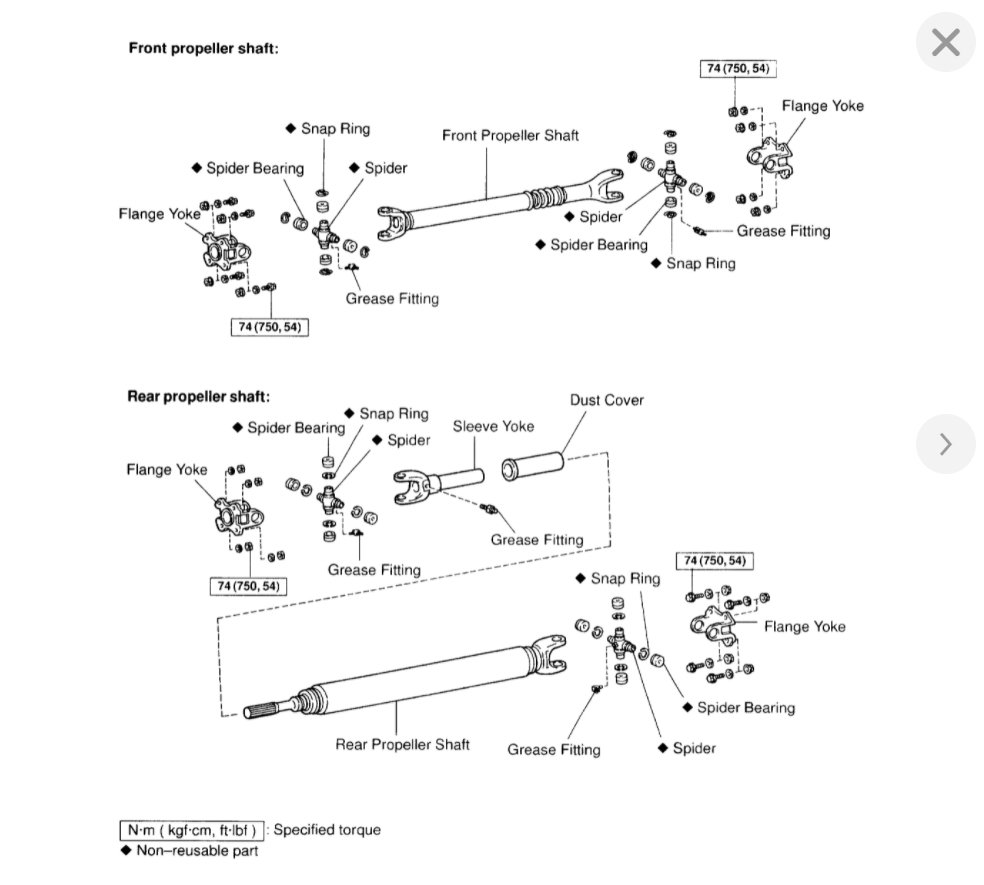

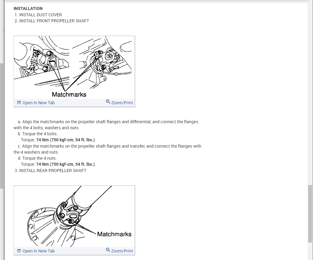

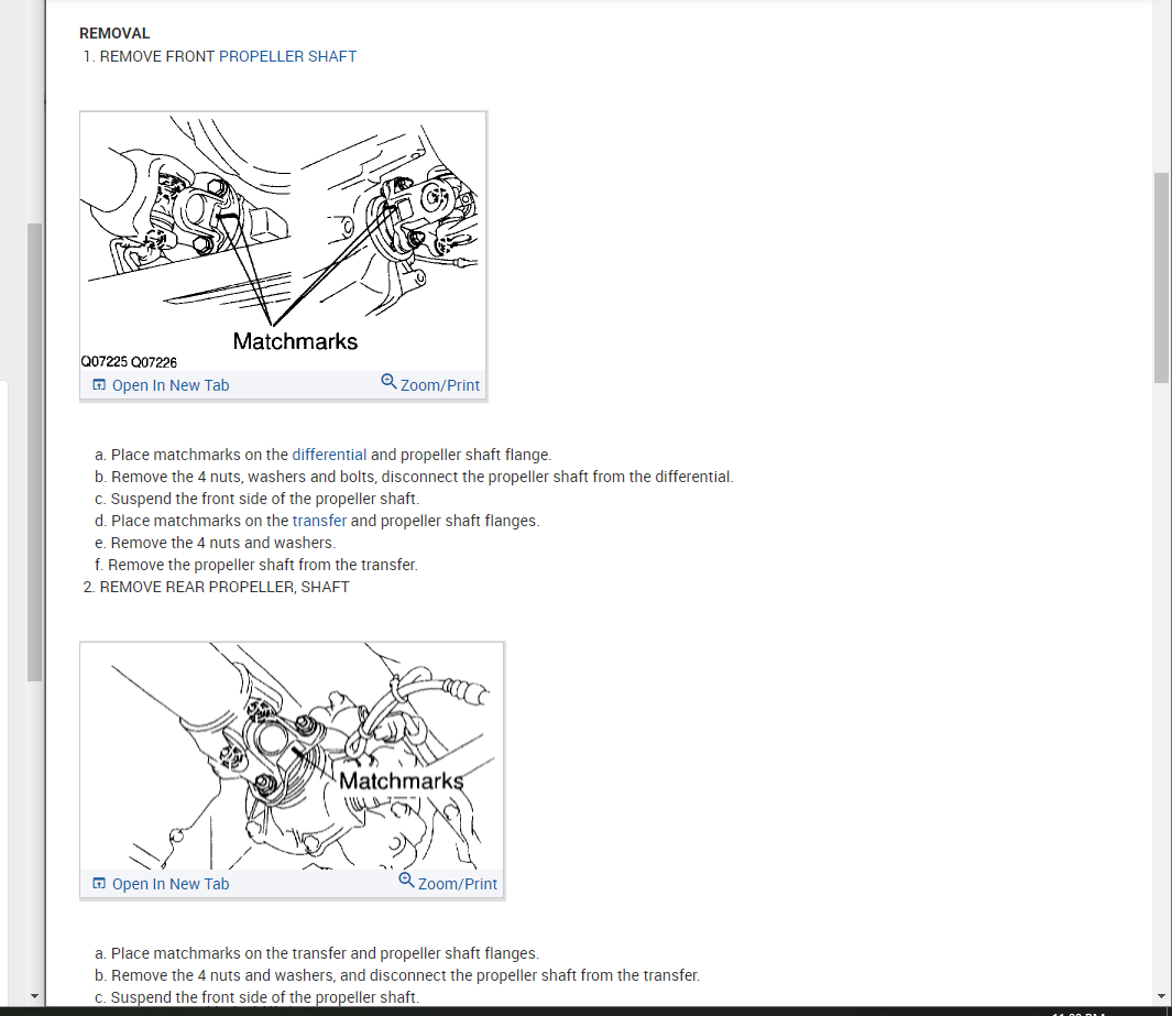

More than likely the seal was leaking prior to this but if removing the drive shaft to replace the u joints the seal was compromised.
Basically the slip yoke when removed can damage the seal.

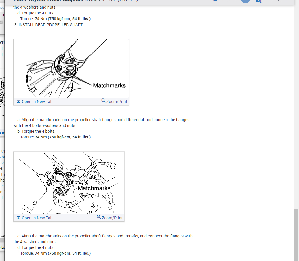

So to replace it we need to just remove the drive shaft again and replace the seal.
https://www.2carpros.com/articles/how-to-remove-a-drive-shaft
I attached the process below on how to do this.
Please run through this and let us know if you have other questions. Thanks
