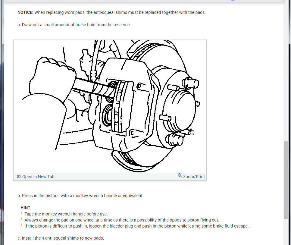

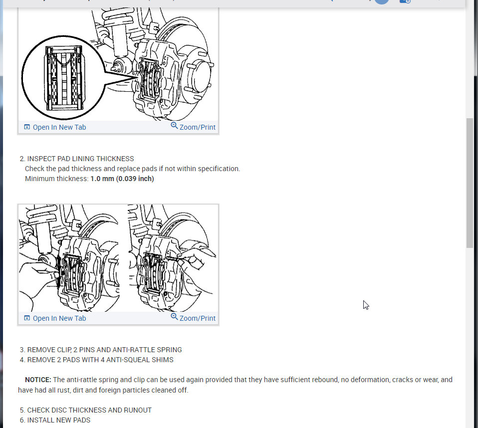

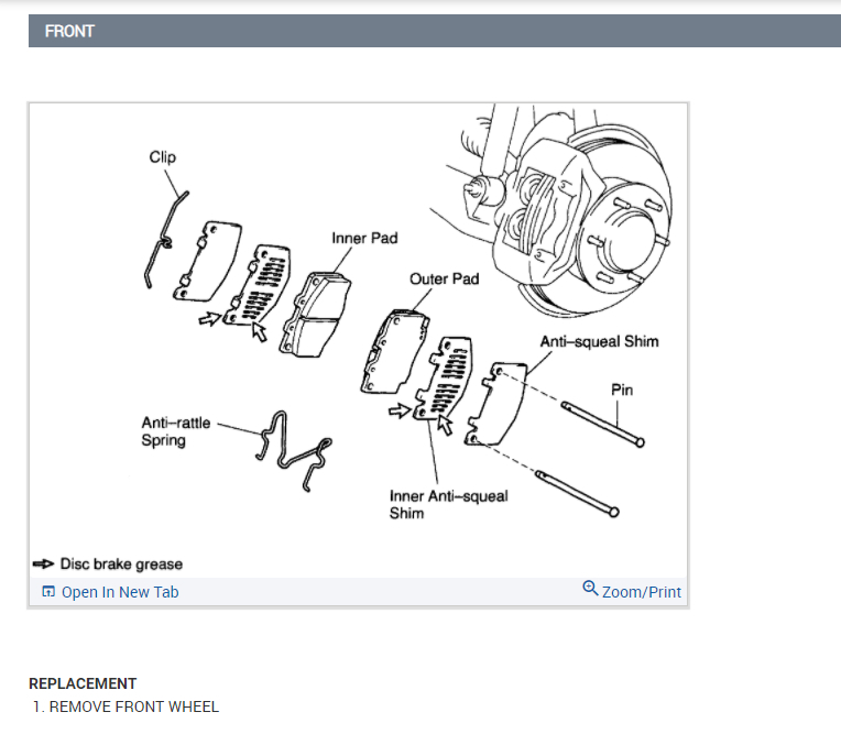

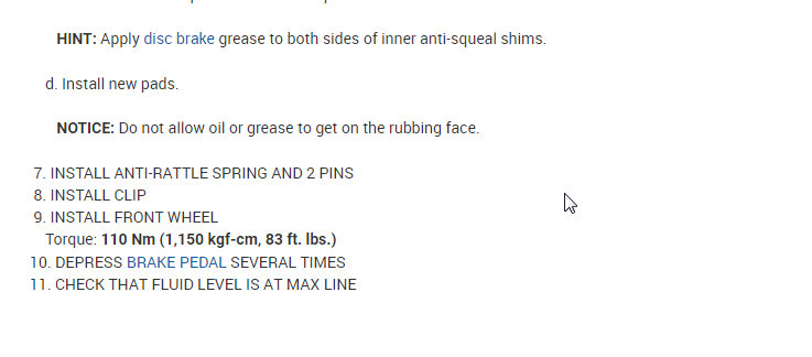

Can someone please tell me the best way to change my front brake pads please?
Aug 5, 2009 at 4:18 AM
Experienced Mechanic
18,907 POSTS
Absolutely. Here are some guides that will get you started:
https://www.2carpros.com/articles/how-to-bleed-or-flush-a-car-brake-system
I attached the process below from the manual. Let us know if you need more info. Thanks
