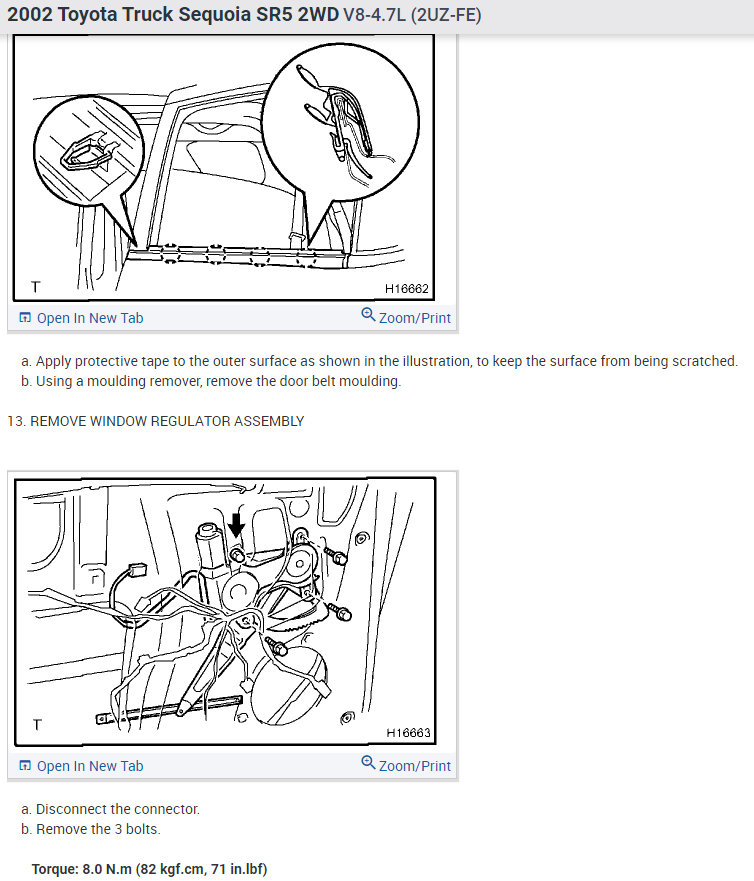

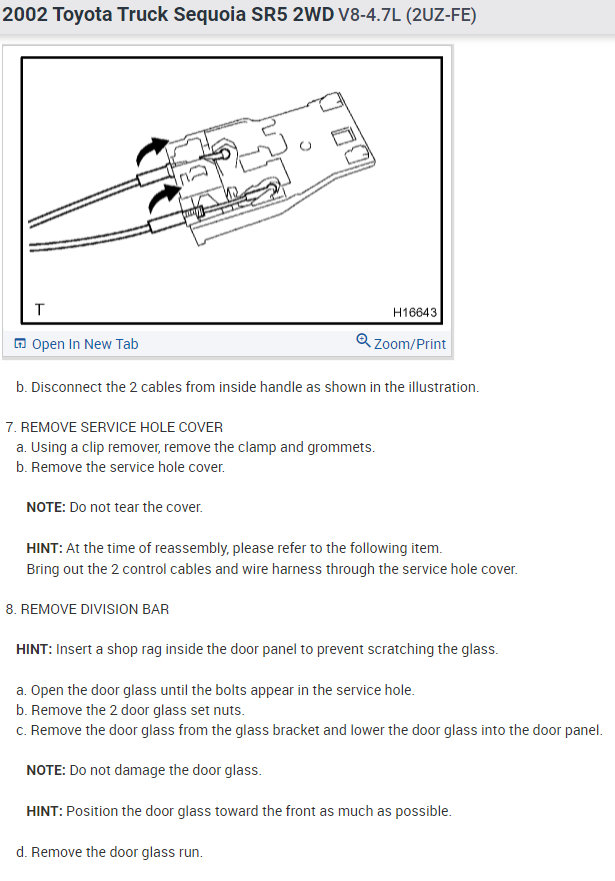

The power rear window does not work with either the dash control, the key remote or with the key in the back door.
Is there a fuse, if so what size and what location in the fuse box would I find it?
Jan 29, 2009 at 1:40 AM
SQM
  • 6,383 POSTS

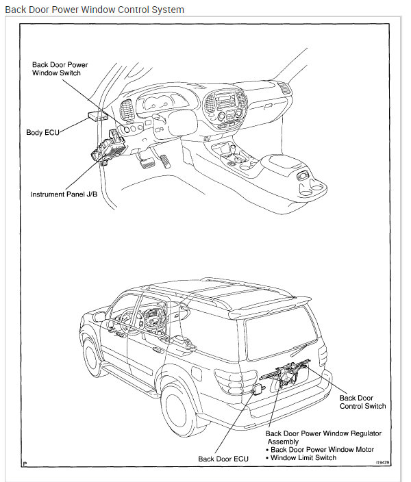

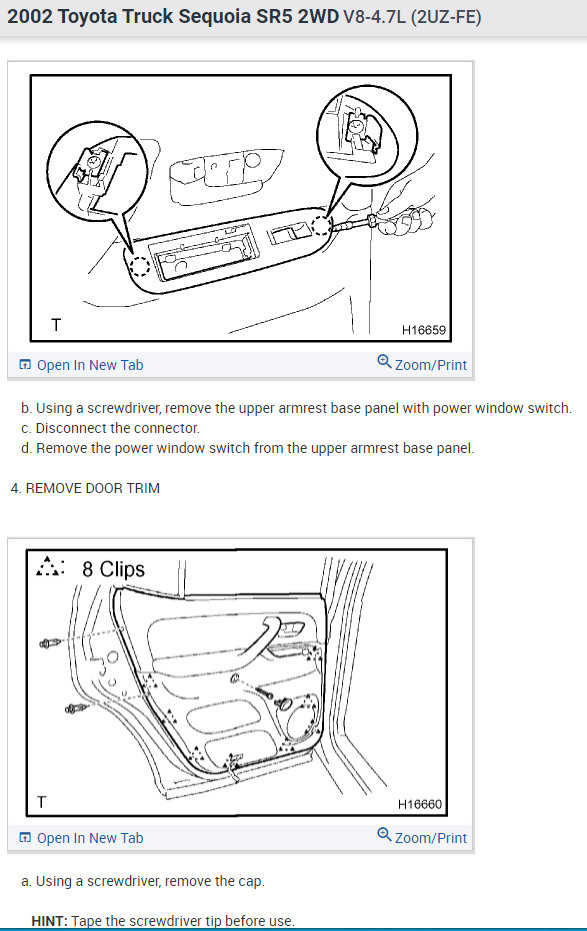

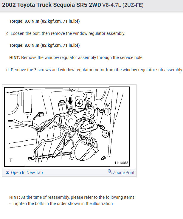

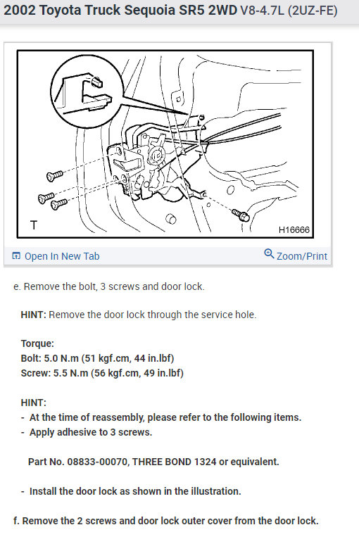

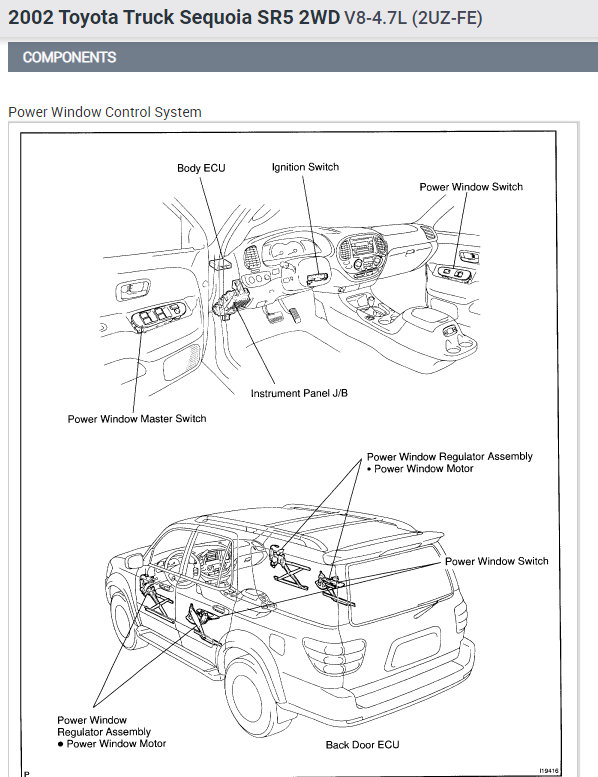

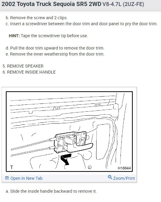

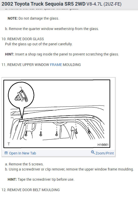

It sounds like you might have a bad window motor.
The windows are centrally controlled, if it was a relay issue you would not have any of the window working.

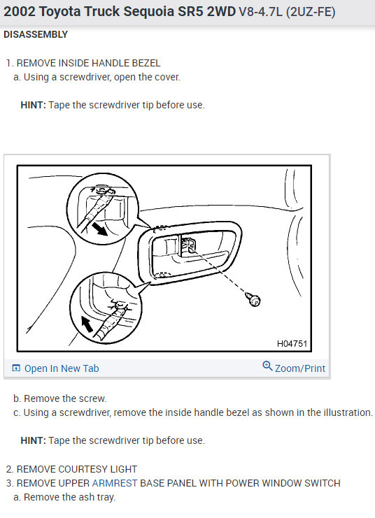

In order to replace the motor you will have to take the inner door panel off.
It can be done using simple hand tools.
You always want to make sure you are getting power to the motor before replacing, in care there is a short in the wire.
You might this helpful:
https://youtu.be/HBFBcJrdym4

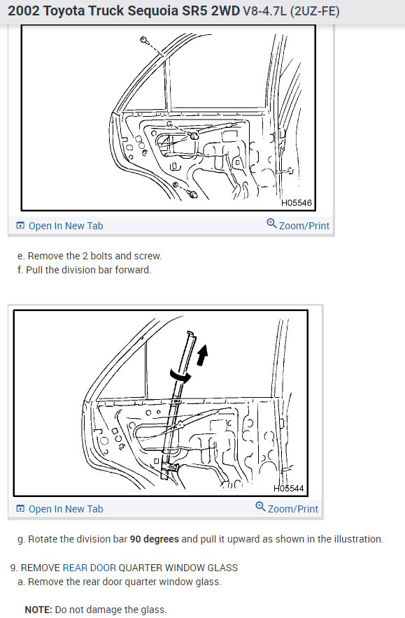

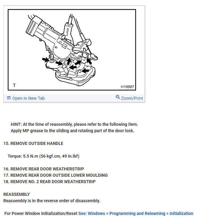

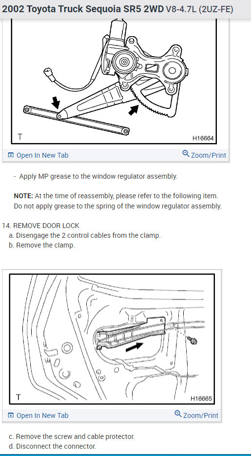

I have attached the window motor replacement procedure for your reference.
