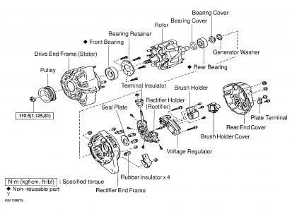

Where is the voltage regulator located? My battery is being over charged so I changed thr alternator and the problem still exists...
Feb 19, 2009 at 2:36 AM
MHPAUTOS
  • 31,937 POSTS
Hi there, The voltage regulator is internal of the alternator (see pic) so i would be getting the alternator re checked as it may still be faulty. Mark (mhpautos)
