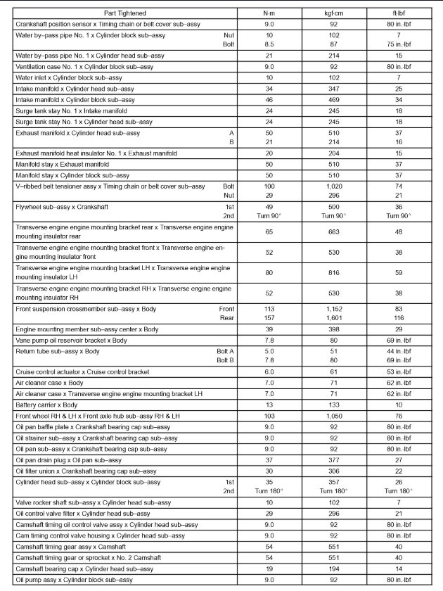

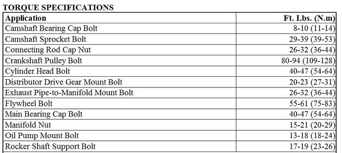

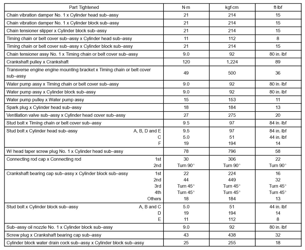

Hi i am rebuilding the engine on a toyota run x 1.6 with a 4zze 587 410 engine and in need of all the torque settings for it
Dec 20, 2018 at 12:39 AM
Experienced Mechanic
55,627 POSTS
Here is a video to show you how to use a torque wrench and the specs in the diagrams below:
https://youtu.be/juOClONIWeY
Images (Click to enlarge)

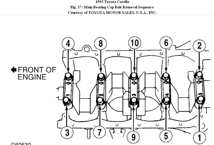

what is the torque specs for crank bolts on 1992 corolla 1.6l
Dec 26, 2020 at 6:51 AM (Merged)
KHLOW2008
41,812 POSTS
Connecting rod cap nuts = 36 ft.lbs. (49 N.m.)
Main bearing cap bolts = 44 ft.lbs. (60 N.m.)
For main bearing caps, tighten evenly in sequence according to diagram.
Image (Click to enlarge)
